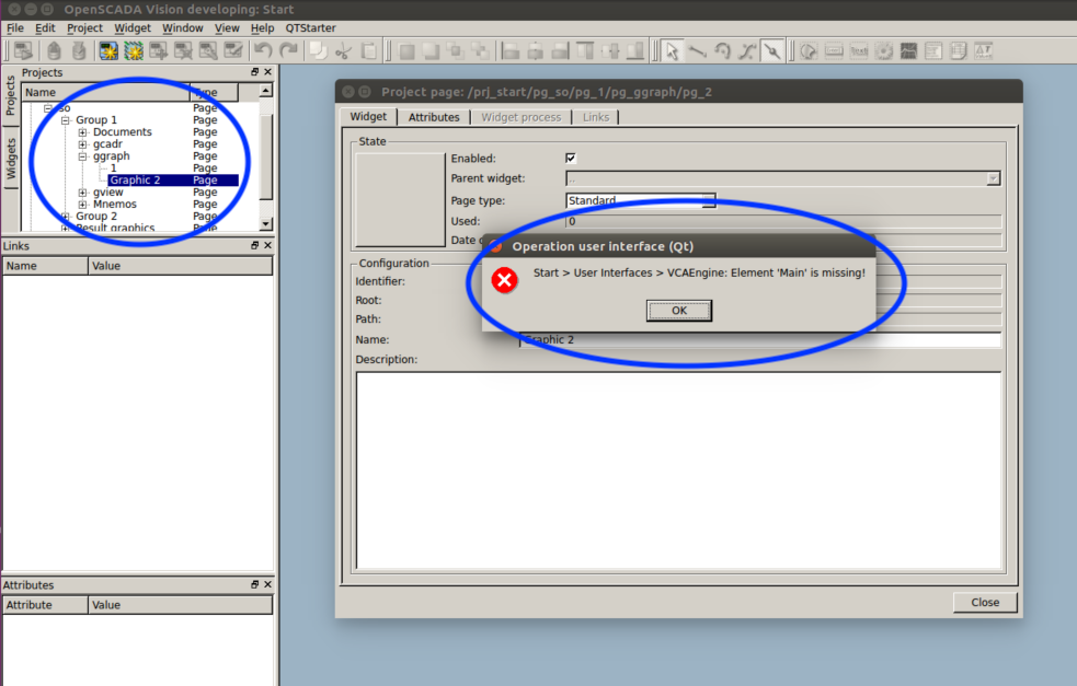

Hello,
I'm not sure what happen. I was working on the Quick Start guide at "5 Formation of the visual representation". I did create "Graphic 2" and was trying to "enable" and access "Links" tab. However, at the beginning, I didn't see the tree of element 'el1' ... 'el8' on "Links" tab. Then, I restarted my Ubuntu machine. When I started Openscada program again, it seems that the icons in the "Projects" pane looks strange and it showed "VCAEngine: Element 'Main' is missing!" when I clicked enable. What did I do wrong? Could you please help?
Thank you very much,
Rangsarit

Сообщение создано: 12. 02. 2019 [08:21]
Connection of the OpenSCADA libraries, and "vcaBase.db" concrete, was not saved or those libraries are not presented in whole.
See to the logs and read the HowTo Debug!

I added LibsDB/vcaBase.db into "DB SQLite" and click "Load the program from this DB". Now, I can enable "Graphic 2" and "el1...el8" appear.
Rangsarit
