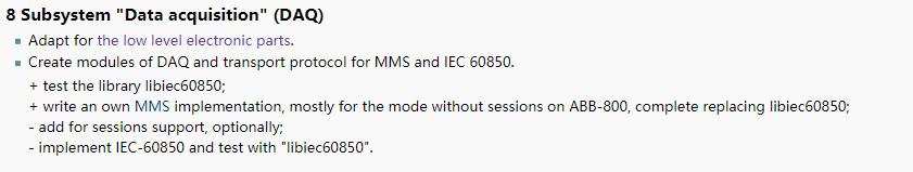

Thank you for your reply.
I have a uncertainty that the page of "To do" show the modules of DAQ and transport protocol for MMS and IEC 60850 will be created instead of IEC18650. It's meaning that IEC61850 will not be developed temporarily.
Looking forward to your reply.Thank you!!!
the part of To Do .PNG (File type: image/png, Size: 13.09 kilobytes) — 2337 downloads
Written on: 09. 05. 2019 [20:01]
This is meant, I will finish the IEC 60850 implementation into the present module "MMS", as the top layer above MMS (IEC-9506), once I will need that, or somebody other will order these functions:
- add for sessions support, optionally;
- implement IEC-60850 and test with "libiec60850".
