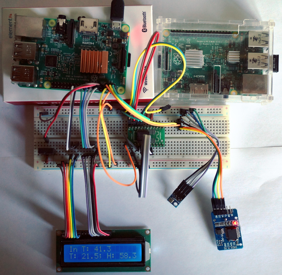

(+) A WIFI module purchasing and connection.
(+) A simple, text, display 1602A purchasing and connection. New module based on libBCM2835 DAQ.BCM2835 appending to OpenSCADA. Write a script to the display 1602A negotiate.
(+) DHT11 sensor connection to OpenSCADA direct.
(+) Module Transport.Serial expand for the bus I2C support.
(+) Sensors purchase and connect it to the I2C bus: PCF8591, PCF8574, DS3231, AT24CXX

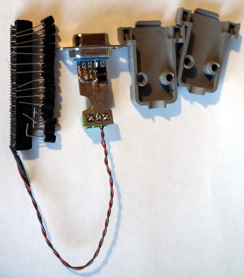

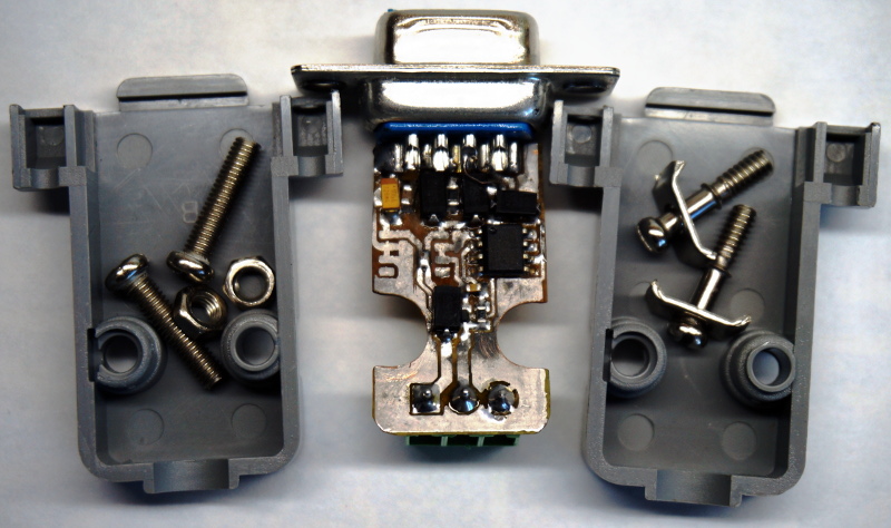

(+) 1Wire adapters DS9097 and DS9097U produce for RS232.
(+) All allowed chips and sensors connect to the 1Wire bus: DS1820, DS2413, DS2408, DS2450, DS2438

(+) Direct configurable implementing of the GPIO devices: DHT, 1602A
