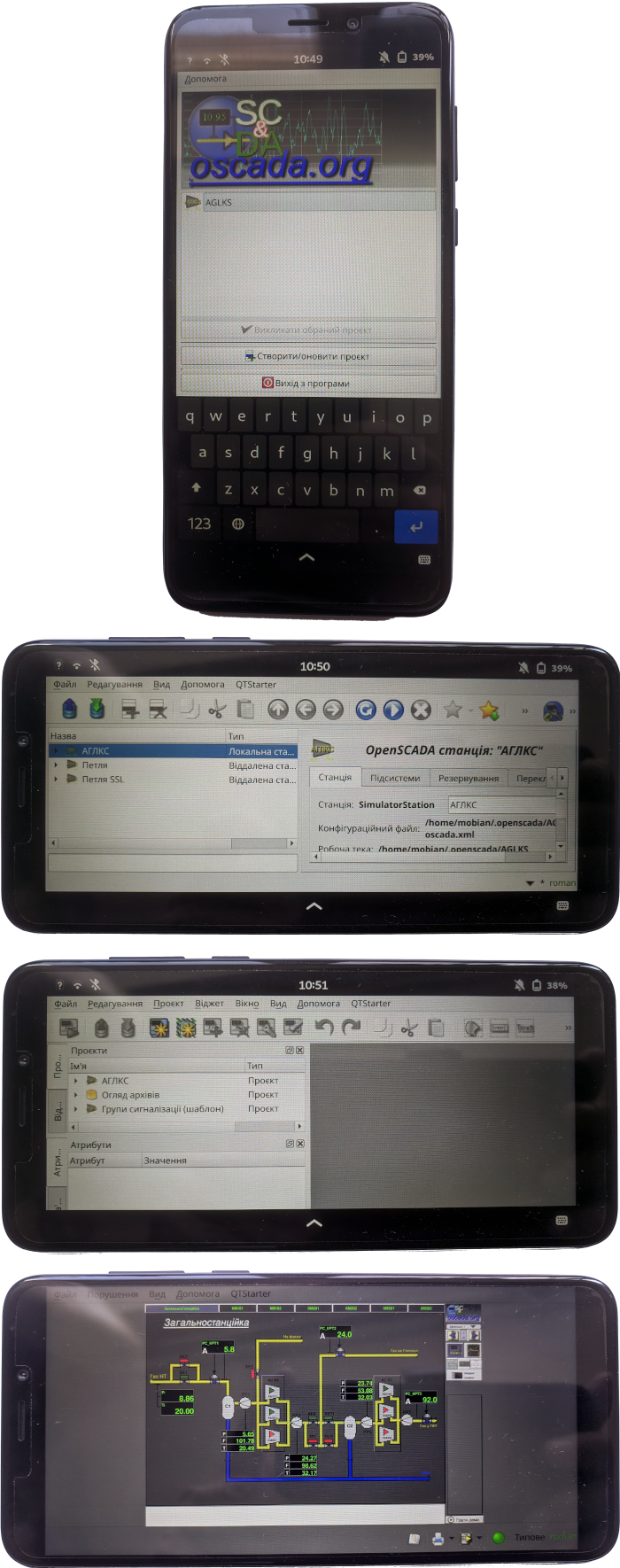

2 Mobian
Mobian is a Debian derivative for mobile devices and it was selected as a familiar one for the OpenSCADA project and which based on a standard packages repository. Since the last Mobian images are grounded on Debian 12 — the test branch, the OpenSCADA project was also appended for early building on Debian 12 for the hardware: x86, x86_64, ARMHF, ARM64.
Mobian also has showed itself as more stable solution comparing to Manjaro — the preinstalled Linux distributive: no crashing GUI, working suspend mode, the predefined PIN, no dead blacking screen, correct updating and so on.
User/password after the installation is mobian/1234 and you may leave them, using by default.
Remote access by SSH is missing by default, so you have to install the standard package openssh-server from the console, also you can install mc — apt-get install openssh-server mc.
Root access is the standard one by sudo — sudo bash.
OpenSCADA installation is the standard procedure for Debian 12, but after OpenSCADA adaption to Qt6 and building with it on Debian 12, we need to install manually the package "qt6-wayland" also.
