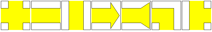

1.1 Elements of pipelines without the gradient fill
The elements in Figure 1.1 serve to construct pipelines of any complexity, required width and color. By default, they are filled in yellow, the rotation angle is 0° and the mirroring disabled.
The pipeline elements include, from the left to the right:
Name (identifier) | Version | License | Author |
Pipe-cross (El_Krest) | 1.0 | GPLv2 | Maxim Lysenko |
Pipe-line horizontal (El_Pipe_simple) | 1.0 | GPLv2 | Maxim Lysenko |
Pipe-line vertical (El_Pipe_simple_vert) | 1.0 | GPLv2 | Maxim Lysenko |
Arrow (El_Strela) | 1.0 | GPLv2 | Maxim Lysenko |
Back arrow (El_Obr_Strela) | 1.0 | GPLv2 | Maxim Lysenko |
Pipe-angle (El_pipe_1) | 1.0 | GPLv2 | Maxim Lysenko |
Pipe-tee (El_Troinik) | 1.0 | GPLv2 | Maxim Lysenko |
Using — development
These widgets can be used by the developer to create mnemonic schemes of the plain pipelines. By the attribute "Color 1" you can change the element filling color. By rotation and mirroring these widgets you can get all the needed combinations. By scaling, you can set the desired pipe width where, for straight sections, the "x" and "y" axis scales may be different, determining the typical pipe width on the mnemonic scheme and the length of its individual section, respectively. To use it you need to add selected ones to a mnemonic scheme, systematically adjust for the geometry and visually connect the needed parts of the pipelines properly, see Addition 1 for the details. For the purpose of systematic and simplified work, you may prepare only first elements and for other pipeline parts use ready copies of these already prepared and placed elements.
Using — runtime
In the runtime mode, these elements look the same as in the development mode because they are not dynamic.

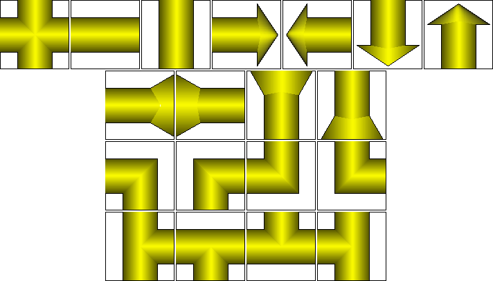

1.2 Elements of pipelines with volumetric filling
The elements in Figure 1.2 serve to construct volumetric pipelines of any complexity, required width and color. By default, the transparent volumetric gradient is filled in yellow.
The pipeline elements include, from the left to the right and from the top to the bottom:
Pipe-cross, volumetric (El_Krest_gr) | 1.1 | GPLv2 | Maxim Lysenko, Roman Savochenko |
Pipe-line horizontal, volumetric (El_Pipe_simple_gr) | 1.1 | GPLv2 | Maxim Lysenko, Roman Savochenko |
Vertical pipe line, volumetric (El_Pipe_simple_vert_gr) | 1.1 | GPLv2 | Maxim Lysenko, Roman Savochenko |
ArrowHR, volumetric (El_Strela_gr) | 1.1 | GPLv2 | Maxim Lysenko, Roman Savochenko |
ArrowHL, volumetric (El_StrelaHL_gr) | 1.1 | GPLv2 | Maxim Lysenko, Roman Savochenko |
ArrowVB, volumetric (El_StrelaVB_gr) | 1.1 | GPLv2 | Maxim Lysenko, Roman Savochenko |
ArrowVT, volumetric (El_StrelaVT_gr) | 1.1 | GPLv2 | Maxim Lysenko, Roman Savochenko |
Back arrowHL, volumetric (El_Obr_Strela_gr) | 1.1 | GPLv2 | Maxim Lysenko, Roman Savochenko |
Back arrowHR, volumetric (El_Obr_StrelaHR_gr) | 1.1 | GPLv2 | Maxim Lysenko, Roman Savochenko |
Back arrowVB, volumetric (El_Obr_StrelaVB_gr) | 1.1 | GPLv2 | Maxim Lysenko, Roman Savochenko |
Back arrowVT, volumetric (El_Obr_StrelaVT_gr) | 1.1 | GPLv2 | Maxim Lysenko, Roman Savochenko |
Pipe-angleBL, volumetric (El_pipe_1_gr) | 1.1 | GPLv2 | Maxim Lysenko, Roman Savochenko |
Pipe-angleBR, volumetric (El_angleBR_gr) | 1.1 | GPLv2 | Maxim Lysenko, Roman Savochenko |
Pipe-angleTL, volumetric (El_angleTL_gr) | 1.1 | GPLv2 | Maxim Lysenko, Roman Savochenko |
Pipe-angleTR, volumetric (El_angleTR_gr) | 1.1 | GPLv2 | Maxim Lysenko, Roman Savochenko |
Pipe-teeVR, volumetric (El_Troinik_gr) | 1.1 | GPLv2 | Maxim Lysenko, Roman Savochenko |
Pipe-teeHB, volumetric (El_TroinikHB_gr) | 1.1 | GPLv2 | Maxim Lysenko, Roman Savochenko |
Pipe-teeHT, volumetric (El_TroinikHT_gr) | 1.1 | GPLv2 | Maxim Lysenko, Roman Savochenko |
Pipe-teeVL, volumetric (El_TroinikVL_gr) | 1.1 | GPLv2 | Maxim Lysenko, Roman Savochenko |
Using — development
These widgets can be used by the developer to create mnemonic schemes of the volumetric pipelines. By the attribute "Fill: color" you can change the element filling color. By scaling, you can set the desired pipe width where, for straight sections, the "x" and "y" axis scales may be different, determining the typical pipe width on the mnemonic scheme and the length of its individual section, respectively. To use it you need to add selected ones to a mnemonic scheme, systematically adjust for the geometry and visually connect the needed parts of the pipelines properly, see Addition 1 for the details. For the purpose of systematic and simplified work, you may prepare only first elements and for other pipeline parts use ready copies of these already prepared and placed elements.
It is not necessary to rotate these widgets as this may cause visual contradiction with other elements of this category, due to the specific of gradient filling. That is why all four element orientations are provided without the need for rotation.
Using — runtime

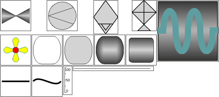

1.3 Different passive elements
The elements in Figure 1.3 are for use in, or around, pipelines.
The different passive elements include, from the left to the right:
Elements of the pipe schemes | |||
Manual valve (El_Armatura) | 1.0 | GPLv2 | Roman Savochenko |
Diaphragm (El_d) | 1.0 | GPLv2 | Roman Savochenko |
Separator (sep) | 1.0 | GPLv2 | Roman Savochenko |
Cooler (cooler) | 1.0 | GPLv2 | Roman Savochenko |
Coil pipe (Teploobm) | 1.0 | GPLv2 | Maxim Lysenko |
Parts of elements of the pipe schemes | |||
Cooler 2 (cooler2) | 1.0 | GPLv2 | Ksenia Yashina |
Rounded rectangle (El_round_square) | 1.0 | GPLv2 | Maxim Lysenko |
Rounded rectangle 1 (El_round_square1) | 1.0 | GPLv2 | Maxim Lysenko |
Rounded rectangle, volumetric (rnd_sq_gr) | 1.0 | GPLv2 | Maxim Lysenko |
Rounded rectangle 1, volumetric (rnd_sq_gr1) | 1.0 | GPLv2 | Maxim Lysenko |
Additional | |||
Line (Line_simple) | 1.0 | GPLv2 | Maxim Lysenko |
Wave-line (El_Obriv) | 1.0 | GPLv2 | Maxim Lysenko |
Scale (Shkala) | 1.0 | GPLv2 | Roman Savochenko |
Ruler (El_Priamaja) | 1.0 | GPLv2 | Maxim Lysenko |
Using — development
These widgets can be used by the developer to create mnemonic schemes with the pipelines. By rotating and mirroring these widgets, you can get all the combinations you want, based solely on the primitive "Elementary Figures". By scaling, you can set the desired geometric dimensions relative to the overall dimensions of the pipe network. To use it you need to add selected ones to a mnemonic scheme, systematically adjust for the geometry and properly visually connect into or between the pipeline elements, see Addition 1 for the details. For the purpose of systematic and simplified work, you may prepare only first elements and for other pipeline parts use ready copies of these already prepared and placed elements.
Using — runtime
In the runtime mode, these elements look mostly the same as in the development mode because they are not dynamic. Some elements, as "Cooler 2", are dynamic but are not linked.

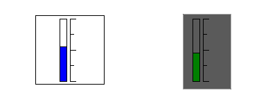

1.5 Level (Level) |
1.0 | GPLv2 | * | en, uk, ru | Maxim Lysenko, Roman Savochenko |
The element on Figure 1.5 is used to display a value histogram of levels of liquid in the technological apparatus. The element commonly uses and represents the representative structure of the "Analog signal" DAQ-template.
Using — development
This widget can be used by the developer to create mnemonic schemes with displaying levels of liquid in the technological apparatus. By the attribute "Fill: color" you can change the bar filling color. By rotation this widget you can get all the needed combinations. To use it you need to add this widget to a mnemonic scheme, adjust for the geometry by the scale and link to the data source parameter.
Using — runtime
In the runtime mode, in the main field of the element, there are displayed a histogram bar, what related to the analog value.
Linking and configuring the attributes
Identifier | Name | Type | Configuration | Configuration template | Description |
var | Value | Real | Input link | Parameter|var | Engineeric real value of the parameter. |
max | Maximum | Real | Input link | Parameter|max | Upper limit value of the parameter. |
min | Minimum | Real | Input link | Parameter|min | Minimum limit values of the parameter. |
fillColor | Fill: color | Color | Constant |

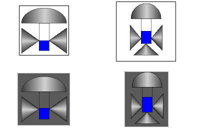

2 Active elements, representing various technological devices
2.1 Discrete apparatus
The elements on Figure 2.1 is used to display the discrete apparatus' status on basis of the discrete signals, for use in pipelines. The elements commonly use and represent the representative structure of the DAQ-template of the discrete block in different visual variants.
The discrete apparatus' elements include, from the left to the right:
Name (identifier) | Version | License | Author | Processing period |
Compressor (Compressor), Compressor 1 (Compressor_1) | 1.2 | GPLv2 | Roman Savochenko, Maxim Lysenko | -1 ms (parent) |
Ball crane (El_Kran_Sh), Bolt (El_Zadvizhka), Crane (Zadvizhka) | 1.2 | GPLv2 | Maxim Lysenko, Roman Savochenko | -1 ms (parent) |
Using — development
These widgets can be used by the developer to create mnemonic schemes with displaying and control of the discrete apparatus. To use their you need to add these widgets to a mnemonic scheme, proportionally adjust for the geometry and link to the data source parameter.
Using — runtime
In the runtime mode, in the main field of the elements, there are represented the apparatus symbolic shape with a dynamic sign of the discrete status, what related to values of the discrete signals of the parameter and the attribute digStts configuration. At the hardware errors and non validity the data, it fills in the gray color.
In the active mode of the element, pressing the left mouse button in the widget body will cause to appear in the panels area for control panel of the parameter, and the selection of this widget will be displayed with the blinking structure color. The commands are duplicated in the context menu that appears when the right mouse button is pressed in the widget area.
The widget supports now of working with very big "Periodic processing" value and that value is set now to inherit from parent widget/page/session (the value -1). That is possible by a mechanism of the events early processing and the possibility of control the processing periodicity from the procedure.
shifr | Parameter: code | String | Input link | Parameter|NAME | Short name of the parameter to be inserted in actions of the user-operator. |
DESCR | Description | String | Input link | Parameter|DESCR | Description or long name of the parameter to be inserted in actions of the user-operator. |
st_open | Parameter: state - "Opened" | Boolean | Input link | Parameter|st_open | The state "Opened" of the parameter or the common state of the switch at missing the state signal "Closed". |
st_close | Parameter: state - "Closed" | Boolean | Input link | Parameter|st_close | The state "Closed" of the parameter. |
digStts | Statuses | String | Input link | Parameter|digStts | Configuration of the parameter statuses with the structure {openedLabel}-{color};{closedLabel}-{color}, for the discrete block. |
com | Parameter: command - "Open" | Boolean | Full link | Parameter|com | The command "Open" of the parameter or the common command of the switch at missing the command signal "Close". |
close | Parameter: command - "Close" | Boolean | Full link | Parameter|close | The command "Close" of the parameter. |
stop | Parameter: command - "Stop" | Boolean | Full link | Parameter|stop | The command "Stop" of the parameter, for cranes. |
digComs | Commands | String | Input link | Parameter|digComs | Configuration of the parameter commands with the structure {openLabel}-{color};{closeLabel}-{color}, for the discrete block, and {com1Label}-{color};{com2Label}-{color};...;{comNLabel}-{color}, for the code status. |

- Perfect fit is more difficult because there is currently no tool to draw one element to the nearest border of another, and it is possible only at a separate calculation of the coordinates. Therefore, it is recommended to partially overlap one element to another, at 100% development scale, after the previous rule and according to the algorithm:
- to pull up the second element to the first, in one pixel step (holding down Shift) until the visual gap disappears, that is, the maximum possible distance remaining there will be 1 pixel;
- compensate this remain by another step of 1 pixel.
The latter rule is obviously not perfect and for a translucent fill color will lead to another defect namely the unevenness of the final color in the connection locations, which can however be used for visual inspection in the design of opaque schemes. But if you still need such an opportunity without the need for separate calculations, then order-motivate the developers to create a tool for reaching out!
Applying these rules can be quite simple to get the result in the figure:
