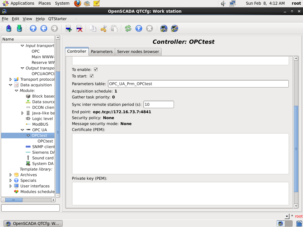

Hi
I used OpenSCADA update 12 and then check OPC UA connection again. But unfortunately I can't write tags. :roll:
Settings are shown in the attached picture.
Please tell me some advise to solve the problem.
Thanks a lot for your attention.
B.R.
Повідомлення створено: 08. 02. 2015 [16:03]
Sure, from update 10 here no significant changes made.
What advice you wait from me if I have not like OPC-UA server? And what I must see from your screen picture?
Actually that you work for observing the problem, then:
- configure single write-able node's value for acquisition into OpenSCADA;
- write "OPC UA" session traffic by WireShark from the OpenSCADA acquisition controller's object start;
- send me the session traffic as *.pcapng file.
But mostly I think you need set proper user and password for allow to writing here, or security policy! Compare the settings with UAExpert work configuration.
And where your client's Certificate and Private key? That is wonder as the client works at all without the certificate and private key!
