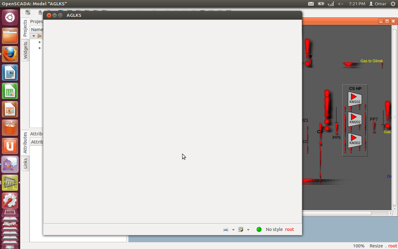

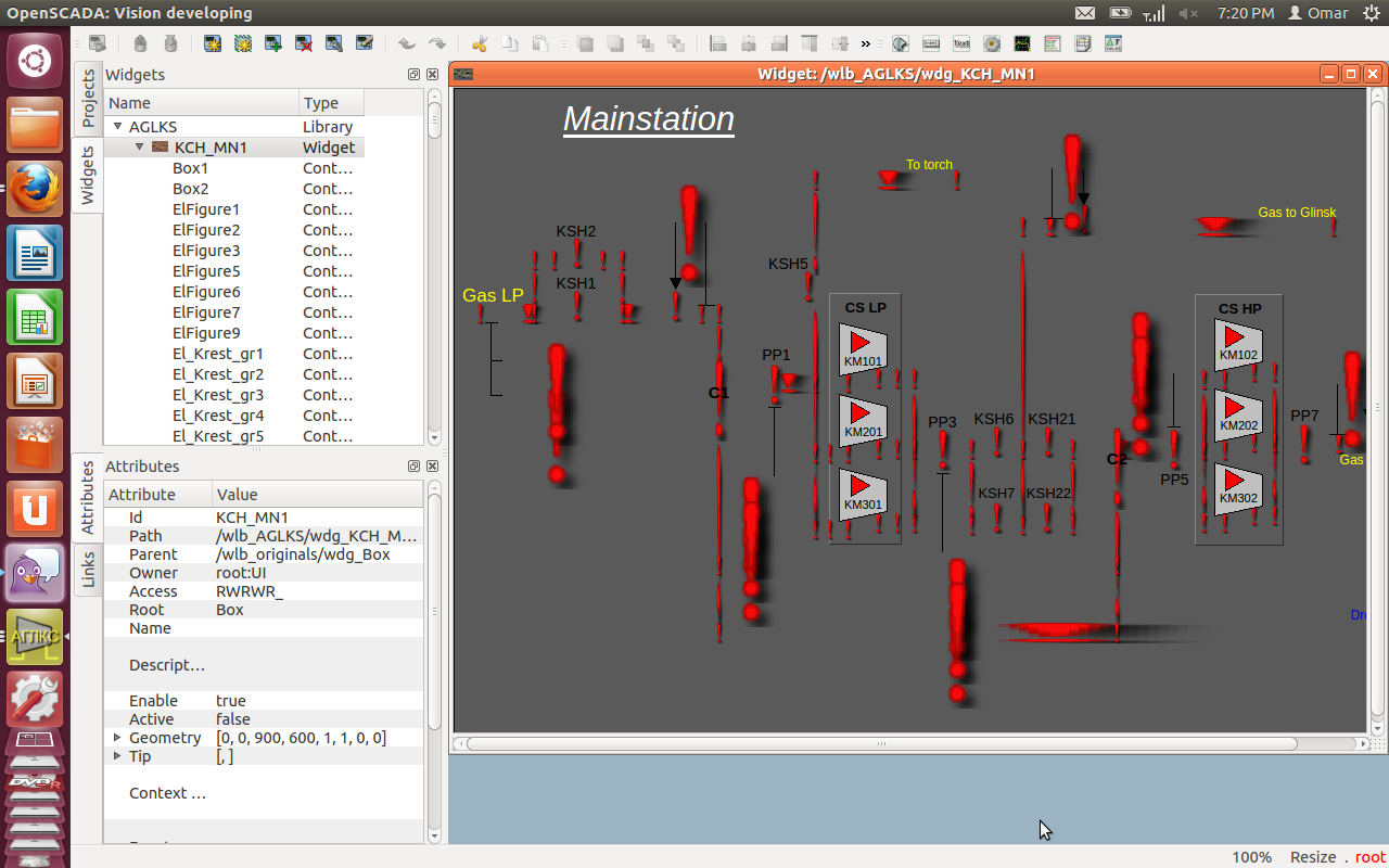

My problem is that when I try to run the aglks and boiler process the screen do not show the controls and visual components that usually shows, ( see images ).

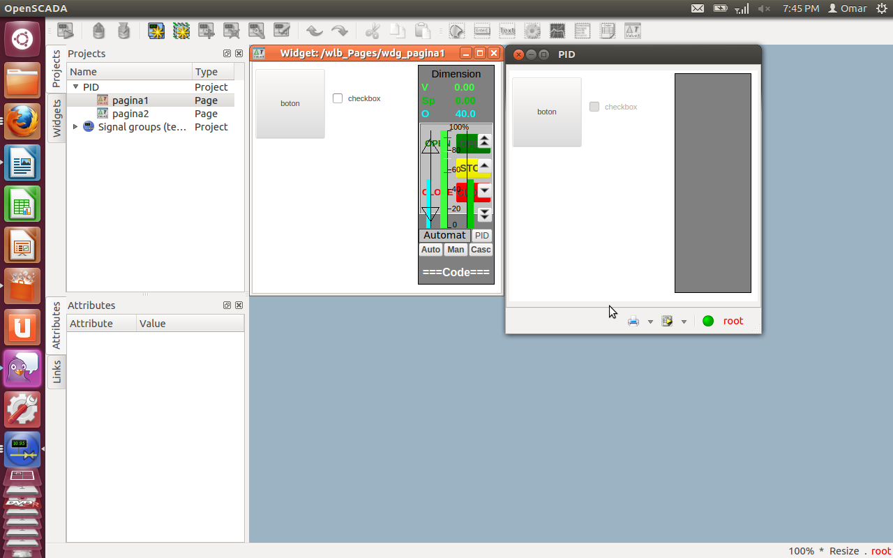

Also in the works station when I add a common pid controller and after try to view it in the project execution can't see the buttons of the controller ( see images ), any idea, where is my mistake, thanks a lot for the support.

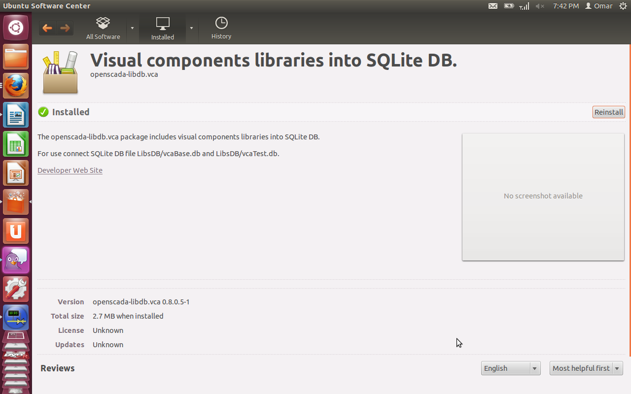

PD: I have also installed the VCA library.. ( see images ).

I have not like problems also on Ubuntu 11.10 and 12.04. And version 0.8.0.5 clean tested into LiveCD/USB.
Try remove or save somewhere directory ~/.openscada and next start AGLKS or Boiler model. Also place here errors into console or OpenSCADA system messages from here: http://wiki.oscada.org/Doc/OpisanieProgrammy/part4/files?get=subsys_arch_mess.png

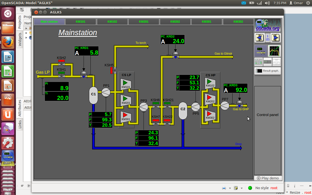

Ok, I follow the instruction of Roman and the result was successful, after run the AGLKS and the Boiler ( both works right after delete the directory ~/.openscada.)
