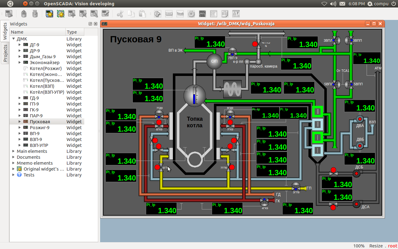

Hello i want to create a GUI of my local technological process so I need to add visual components like
pipelines, cranes, valves, etc.
I know that in OpenScada there are widgets ready to use, and I want to use those on my GUI, but I need to know how can I resize the pre-ready widgets to fit a size optimum for my technological process screen, see the attached images as example.
For example how can I reduce the size of the pipe, valves ( picture 1 ) to looks like the pipes, valves of the ( picture 2 ).
Thanks a lot.
Picture A.png (Тип файлу: image/png, Розмір: 138.32 кілобайтів) — 3192 завантажень
Picture B.png (Тип файлу: image/png, Розмір: 193.02 кілобайтів) — 3270 завантажень
