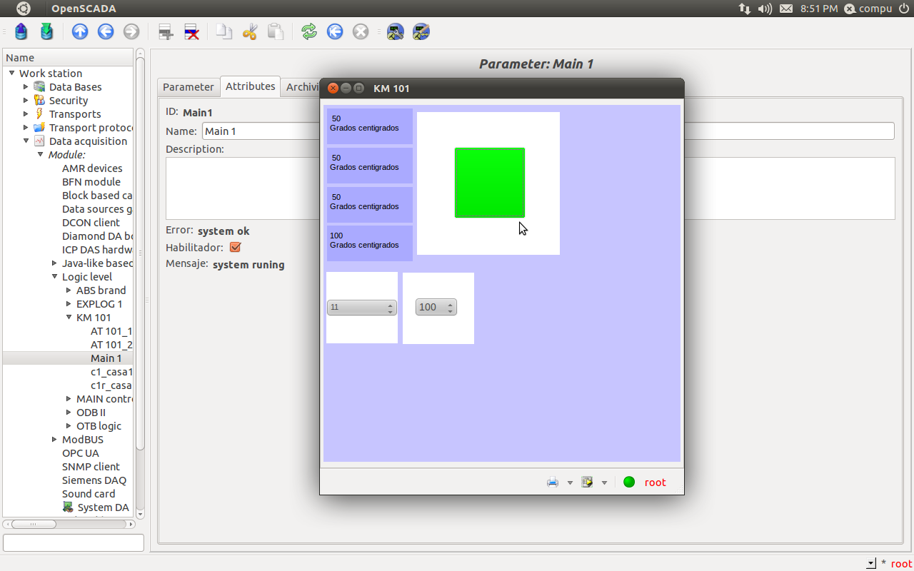

Advancing with my knowledge of openscada I am in the creation of GUI, and I have a little problem
in the side of the system configurator I have create a boolean parameter to be my global system “enabler” ( see attached image ), when I select it in the “logic level” it works right.
So I decided to insert inside my experimental GUI a “button”, to enable and disable my data acquisition, but I can find the right way to configure this button and link with the “parameter enabler” at the “logical level”.
Do you have an example of how to create and configure the button to handle this simple link, assignation between the
Button in GUI
and the
“enabler” in logical level

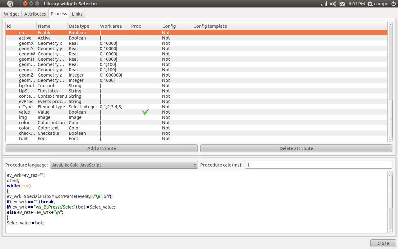

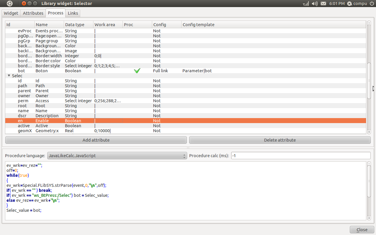

Ok, I had been reading the quick start and have duplicated all on it, but in the Quick start there is not an example use of
a "button" in the user interface it have the example for a "combo box" use, but not the use of a "button".
Any way I try to adapt the logic of the combo box case to the use of a button and have the follow program for the processing of it
ev_wrk=ev_rez="";
off=0;
while(true)
ev_wrk=Special.FLibSYS.strParse(event,0,"\n",off);
if( ev_wrk == "" ) break;
if( ev_wrk == "ws_BtPress:/Selec") bot = Selec_value;
else ev_rez+= ev_wrk+"\n";
Selec_value = bot;
My big problem is that i don't know how to configure the process tab for the widget that contains the button,
the widget only have the button inside at this moment.
I am looking for examples on the AGLKS and the Boiler but the widgets have a lot of items inside them and the processing is global, and still do not found a basic example of how configure the button and its processing program to link it with the logical level and the external world.
Please could you review where i am wrong, could some dude give me any light on this.
Thanks a lot.

The script is correct.
Do you set attribute "Checkable" for the button?
Do you set link to the parameter into "Link" tab (http://wiki.oscada.org/HomePageEn/Doc/QuickStart/files?get=ui_mn2_lnk.png)?
