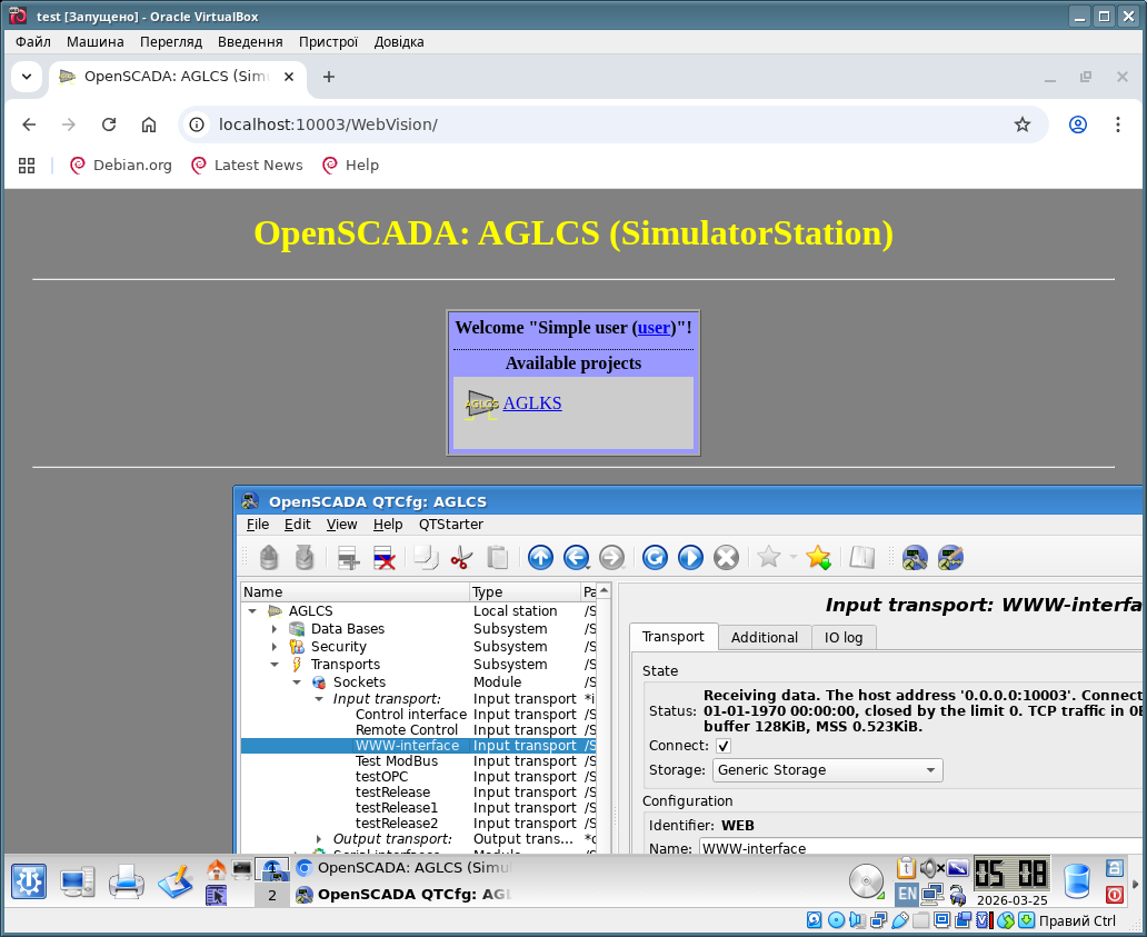

Hi,
I'm migrate to new virtual machine, installed Debian_13-OpenSCADA_1+r3056-TDE_R14-amd64-LiveCD_USB.iso
On the web interface standard login to user. And on try to open Operation user interface show "There is no session and project of the VCA engine for the user!"
same message on AGLKS and Boiler
Migrating from old system thru backup and restore, and next try direct copy project folder. Same effect.
On old machine web VCA working, system oscada have OpenScada 1+r3056.
screenshot from not work web VCA attached.
I tried a live installation Debian_12-OpenSCADA_1+r2961-TDE_R14-amd64-LiveCD_USB.iso
What am I doing wrong?
regards Jozef

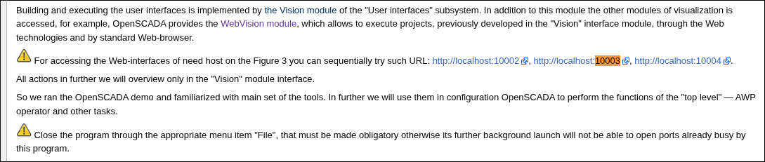

It is you only are connected to a background Server service where is no VCA-Session, obviously! :)
If you want to connect just started model in UI, you may use next WEB-port — 10003.
And read Quick Start for understanding!

I couldn't find the quick start in the manual, number 1003. 10003 doesn't do anything either. It doesn't matter.
I reinstalled the system on debian 13.
I added the repositories as instructed and a new restriction on SSL signature rejection appeared.
I override it via edit /usr/share/apt/default-sequoia.config and set sha1.second_preimage_resistance to a later date.
Then apt install openscada works.
Now the system works on port 10002
thank You
Повідомлення створено: 25. 03. 2026 [07:09]
And me can ...
