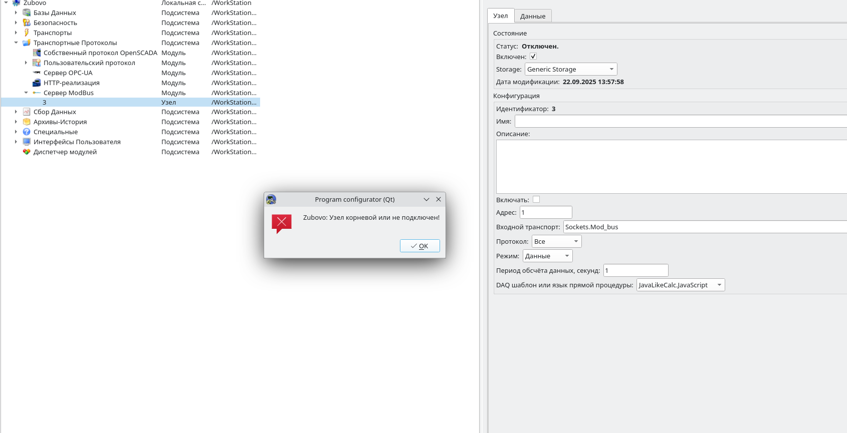

Hello collogues.
Please help with problem:
I try add and entry in modbus_server (TCP_IP).
But then i try start it I have error. Node not a root or not connected.
Повідомлення створено: 22. 09. 2025 [15:07]
I have no problem there whether on a new project or the AGLCS model and the last Work and LTS versions.

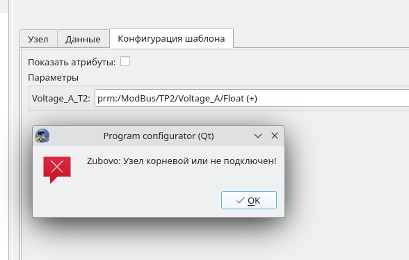

Thanks a lot.
Now error appear in Template config tab =)
But looks like working well.
V1+r3045
V1+r3045
Not clean 1+r3045 due to I have no such errors in any Logical Level based module, that is your installation wrongly updated!
Get a Live Disk for clean testing!!!
