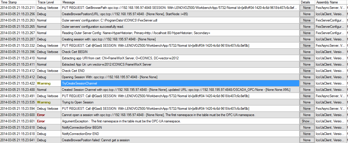

Нашел в логах Genesis64 ошибку
HTML
<record level="800" timestamp="2014-03-05T16:52:54.859" processID="6532" threadID="86" file="Unknown" lineNo="0" SeqNo="919666" colNo="0" processName="C:\Program Files\ICONICS\GENESIS64\Components\IcoFwxServer.exe" threadName="Session Worker: opc.tcp://192.168.195.97:4848 - [None:None]" appDomainID="50081034" appDomainName="IcoFwxServer.exe" assemblyName="IcoUaClient, Version=10.80.118.0, Culture=neutral, PublicKeyToken=58aa7495915e8ed4" assemblyCodebase="file:///c:/program files/ICONICS/genesis64/components/IcoUaClient.DLL" namespace="Ico.Fwx.Ua.Client" class="UaClientSession" method="a(String A_0, PasswordCache A_1, Boolean A_2, String&amp; A_3)">
  <message>Cannot open a session with opc.tcp://192.168.195.97:4848 - [None:None], The first namespace in the table must be the OPC-UA namespace.</message>
</record>
<record level="800" timestamp="2014-03-05T16:52:54.860" processID="6532" threadID="86" file="Unknown" lineNo="0" SeqNo="920493" colNo="0" processName="C:\Program Files\ICONICS\GENESIS64\Components\IcoFwxServer.exe" threadName="Session Worker: opc.tcp://192.168.195.97:4848 - [None:None]" appDomainID="50081034" appDomainName="IcoFwxServer.exe" assemblyName="IcoUaClient, Version=10.80.118.0, Culture=neutral, PublicKeyToken=58aa7495915e8ed4" assemblyCodebase="file:///c:/program files/ICONICS/genesis64/components/IcoUaClient.DLL" namespace="Ico.Fwx.Ua.Client" class="UaClientSession" method="a(String A_0, PasswordCache A_1, Boolean A_2, String&amp; A_3)">
  <message>ArgumentException : The first namespace in the table must be the OPC-UA namespace.</message>
  <details>
    <exceptionStackTrace>System.ArgumentException
   в Opc.Ua.NamespaceTable.Update(IEnumerable`1 namespaceUris)
   в Opc.Ua.Client.Session.FetchNamespaceTables()
   в Opc.Ua.Client.Session.Open(String sessionName, UInt32 sessionTimeout, IUserIdentity identity, IList`1 preferredLocales)
   в Ico.Fwx.Ua.Client.UaClientSession.a(String A_0, PasswordCache A_1, Boolean A_2, String&amp; A_3)
</exceptionStackTrace>
    <stackTrace>   в Ico.Fwx.Ua.Client.UaClientSession.a(String A_0, PasswordCache A_1, Boolean A_2, String&amp; A_3)
   в Ico.Fwx.Ua.Client.UaClientSession.a(String A_0, PasswordCache A_1)
   в Ico.Fwx.Ua.Client.UaClientSession.f(String serverUrl)
   в Ico.Fwx.Ua.Client.UaClientSession.d(Object A_0)
   в System.Threading.ExecutionContext.RunInternal(ExecutionContext executionContext, ContextCallback callback, Object state, Boolean preserveSyncCtx)
   в System.Threading.ExecutionContext.Run(ExecutionContext executionContext, ContextCallback callback, Object state, Boolean preserveSyncCtx)
   в System.Threading.ExecutionContext.Run(ExecutionContext executionContext, ContextCallback callback, Object state)
   в System.Threading.ThreadHelper.ThreadStart(Object obj)
</stackTrace>
  </details>
</record>

Не помогло для 2063. Думаю что добавление NS 100 случайным образом и не должно было помочь. Слишком уж просто все было бы. Вряд ли проблемы в серт. клиенте, который также работает с серт. серверами. Я могу предположить, что он клиент Genesis64 работает более строго, чем остальные клиенты.
И о чём это говорит, разве только о проблемах с таблицей NS у клиента.
А таблицу NS клиент строит не получая ли ее от сервера ? Почему с другими серверами нет проблемы с таблицей NS ? Может как раз потому, что у других серверов эти NS присутствуют и в нужном синтаксисе и содержании ?
Добавил скриншот полного лога как появляется ошибка и весь лог.
IcoFwxServer2063.exe.log.xml.zip (Тип файлу: application/x-zip-compressed, Розмір: 13.01 кілобайтів) — 738 завантажень

Почитав спецификацию увидел там ссылку индексов NS на список NameSpaces в параметре 2055.
Поглядев на дамп с сервером UA увидел, что связь прослеживается, поскольку значения NS не превышает 5, размерности списка NameSpace.
Однако в случае с Ignition такой связи нет, тут ещё вечером погляжу на список NS.
Собственно в OpenSCADA добавил NS3 для DAQ узлов OpenSCADA, а для sessionId и authenticationToken установил NS в 1 и 0, как в UA-Server.
Проверяйте!
