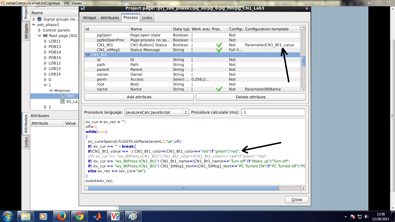

hello sir,
Is there any way to change the things(ex. text, color, etc) in user interface front-end on "button value" instead of "button press event i.e --> ws_BtPress:".
I have added one line in the front end code but it is not taking effect.... neither it is taking any effect.
Kindly have a look at the image added.
or
if making things change in user interface front-end on "button value" is not possible.....
can we use the same button press event in "Java-like based calculator", which we used while creating widget..... if yes then how do I do it ?

Повідомлення створено: 26. 12. 2013 [22:47]
For buttons events processing is single way exclude check-button where you can get the "value" attribute.
Sure, you are wrong and no real process any events but place your code into events processing loop.
For examples see to test form's elements where some button's events process.
But bellow you have true processing for event from button "CN1_Bt1" but why you comment next line and don not place all three lines to single condition like:
if(ev_cur == "wsBtPress:/CN1_Bt1")
  //line1
  //line2
  //line3
At all you can observe for what events pass by place print test messages code before your problem's line like that:
SYS.messInfo("TEST Wdg","Event: "+ev_cur);
And see next to console or messages archive: http://wiki.oscada.org/HomePageEn/Doc/ProgrammManual/part4/files?get=subsys_arch_mess_en.png
