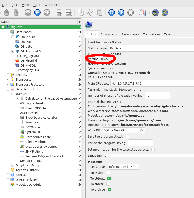

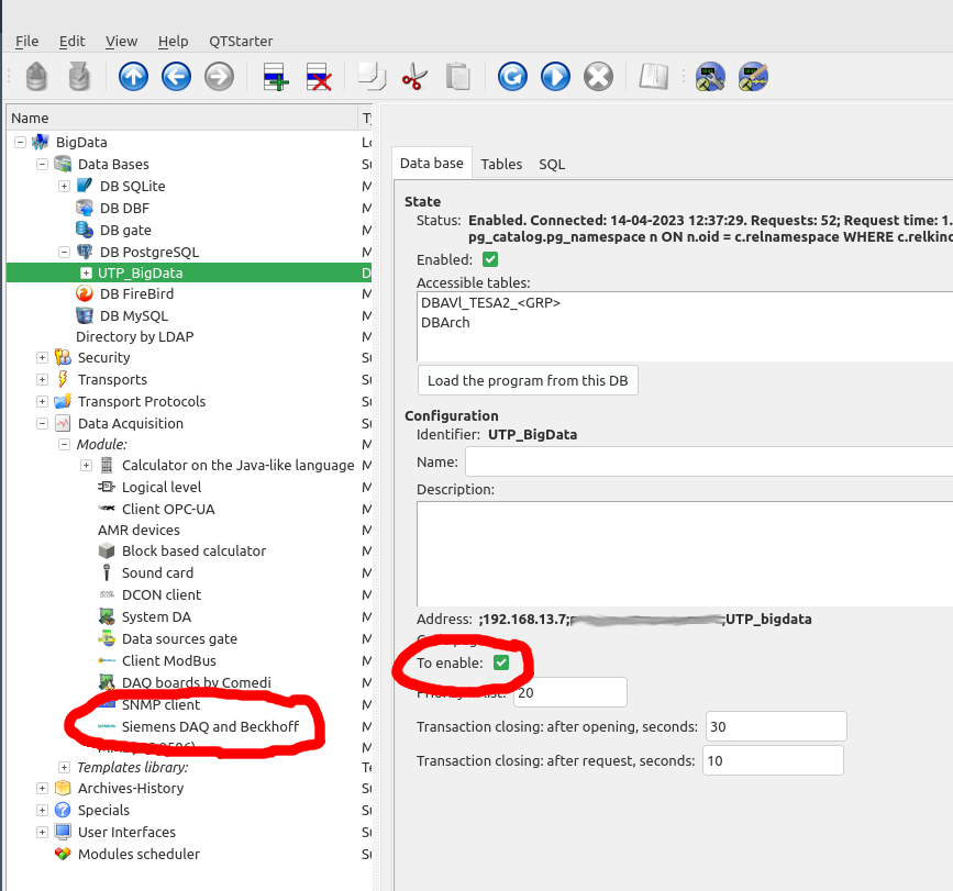

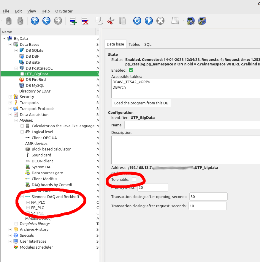

If I have two different database (SQLite and PostgreSQL), openSCADA can't load Data Acquisition's config properly if all databases "To enable".

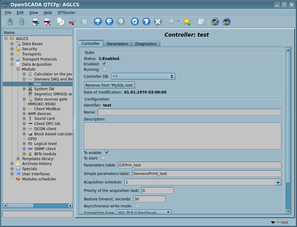

I can, and that works in loading from MySQL and SQLite.
Not a bug!

Templates library loads - OK. I can't load Siemens DAQ and Beckhoff

It is in the "Work DB", which is specific one and always downloaded in the first!
Not a bug!!!

Please see demo video
bug demo

Previous (0.9.4, 0.9.3...) versions work perfectly. This problem is only with new versions 0.9.5, 0.9.6. I tried the AGLKS configuration and got the same problems.

So, that was a problem in DB.PostgreSQL which reproduced only at loading this DBs type from the program start and at new Tables creation.
- !!:FIX:DB: Processing the table emptiness some softened during problems in DB.PostgreSQL about that, that is no exception generated now.
- !!:FIX:DB.PostgreSQL: Switched to the standard way of detection the missing Tables with it creation at "toCreate" and the exceptions generating else, so preventing the message "Table is empty.".
