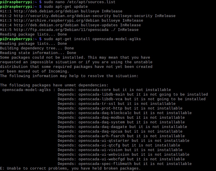

I also tried to Install OpenSCADA from ready-made packages as following step:
1: edit the /etc/apt/sources.list file by inserting one line:add "deb http://ftp.oscada.org/Debian/11/openscada ./
2. Adding the signature verification key (the authenticity) of the repository and packages in it (not necessarily and not in all repositories): $ sudo wget -O - http://ftp.oscada.org/Misc/pkgSignKey | sudo apt-key add -
3. $ sudo apt-get update
4. $ sudo apt-get install openscada-model-aglks
Then display:
ARMHF is not ARM64, so use 2022-04-04-raspios-bullseye-armhf (Raspberry Pi OS)

Ok, I see. It's 32bit system with desktop, it means that OpenSCADA is not support OS-64bit, right?
Повідомлення створено: 29. 04. 2022 [15:06]
It means there is no ready build for ARM64.
