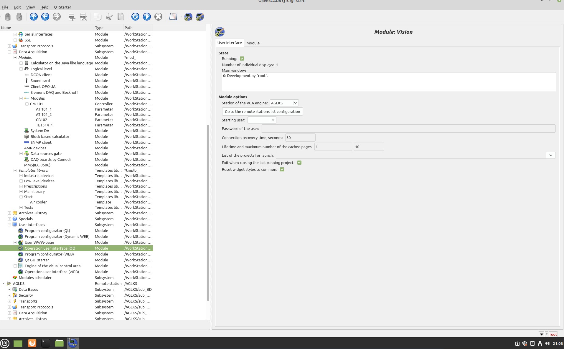

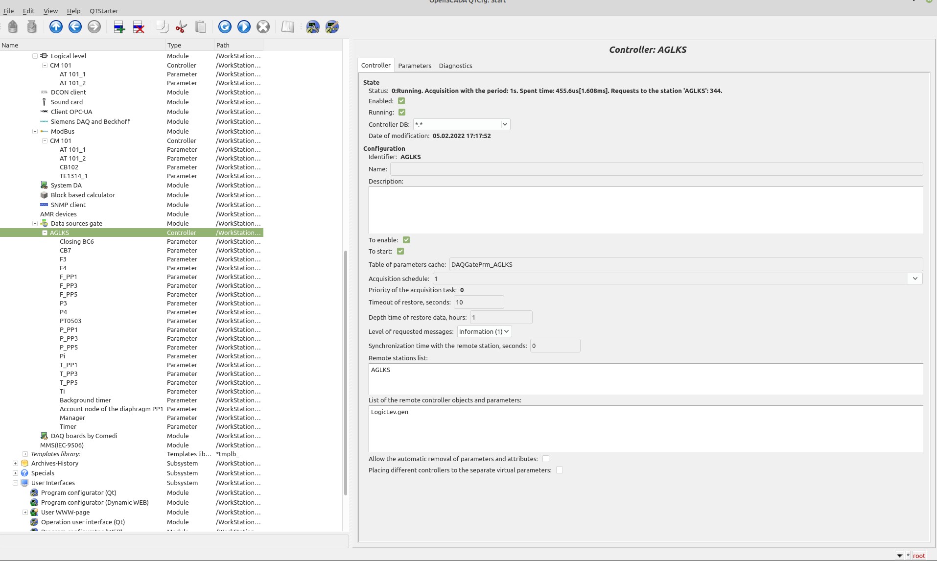

at the moment I try to work trough the tutorial and at step 5.1 (Fig.5.1.5) I have an problem I can not fix
When I try to add the modbus complex object-tag "ModBus.CM101.TE1314_1" I can not find CM101 but instead testRTU and testTCP (see screenshot_1)
I think that the HMI is connected with the AGLKS and not with the Start Project can somebody tell me were I can check that?

You have not performed step 4, 4.1 obviously and step 5 in whole you must implement in your new project described in step 3.3, so do all the Tutorial sequentially.
And the Quick Start document is correct!!!

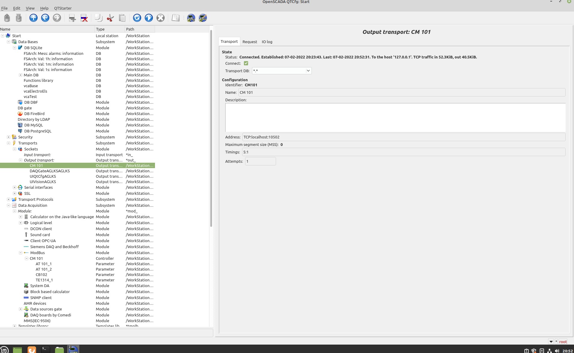

I just double checked step 4.4.1 (screenshot_2) and to me every ting seems to be fine, exept the fact that in fig4.4.1 in the list of remote controls I chose LogicLev.gen (according to the text) and there is no LogicLev.experiment for me (according to the Picture).
also the data Archive is running fine.
But still the same Problem :bang:

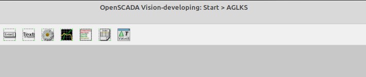

but I noticed that the head line of the Vision tool says Start > Aglks instead of just start (Screenshot_3) is that related to the Problem or just a new feature
And have not returned the remote connection:
This configuration of the remote connection to the visualizer server is not necessary to save and the configuration field "Station of the VCA engine" (Fig.3.3.1.2) should be returned to Local and the station user set to root; only then save.
So, you just try to perform step 5 on the remote AGLKS project.

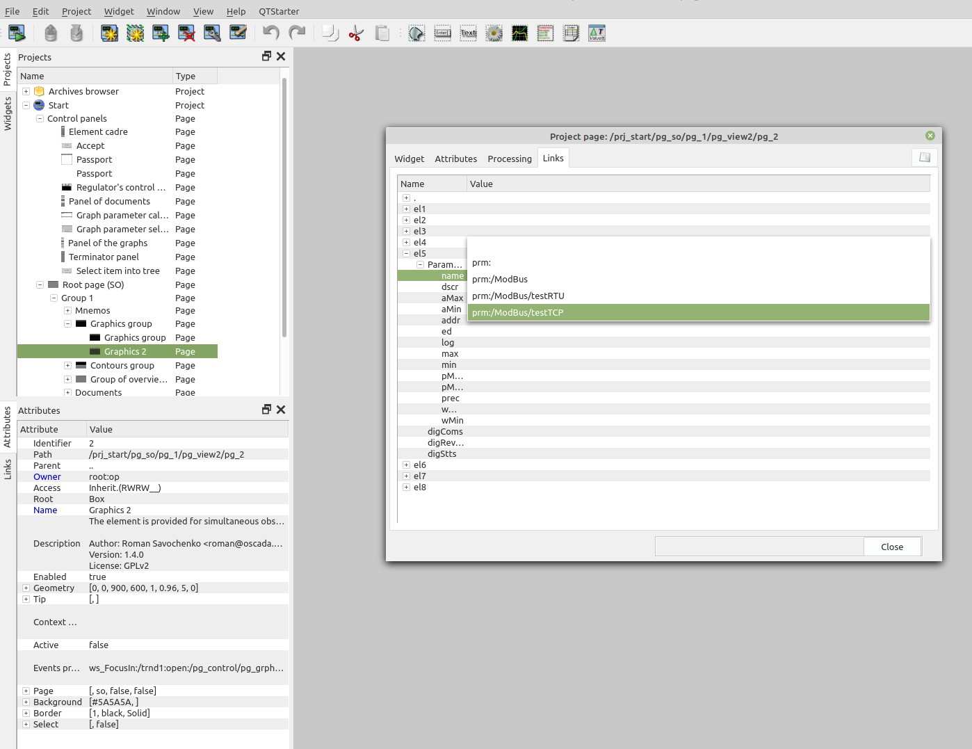

This is the config of the CM101 in Data acquisition (Screenshot 4)

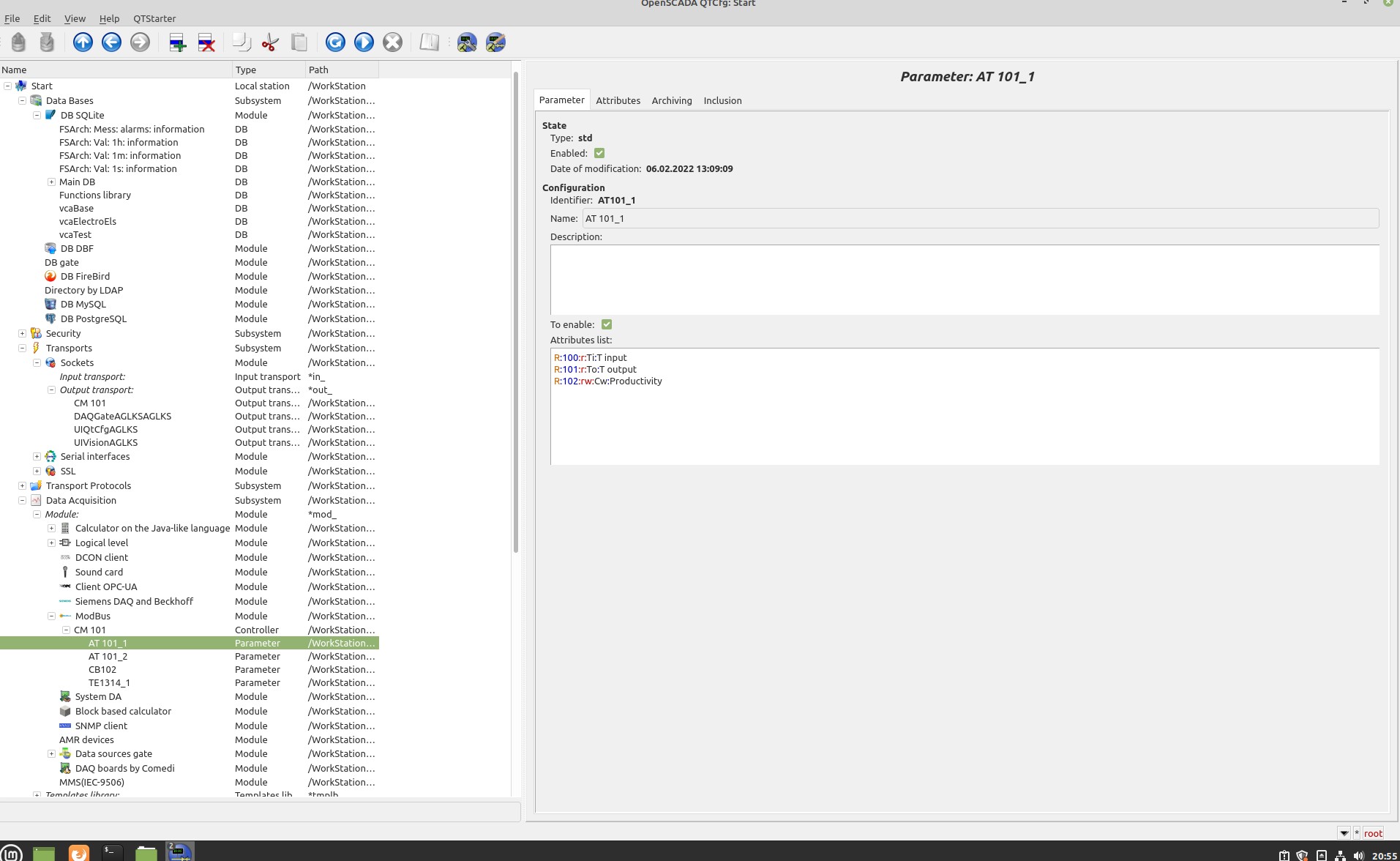

This is the config of the CM101 in Transport (Screenshot 6)

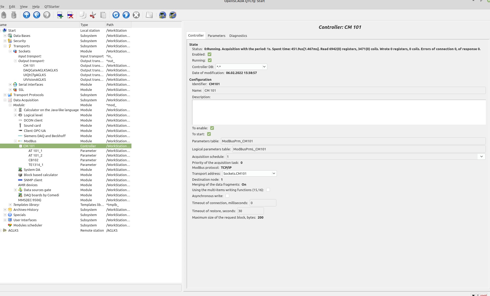

An this the config of the AT 101_1 (Screenshot 5)

Повідомлення створено: 07. 02. 2022 [22:08]
"Streicher" wrote:
same here
So do that at the last!

The Tow Things I missd was :
1: I did not set back the station to local in step 3.3.1
2: I did not download and enable the Libs in step 3.3.2
Again thanks for your patience and have a nice evening
