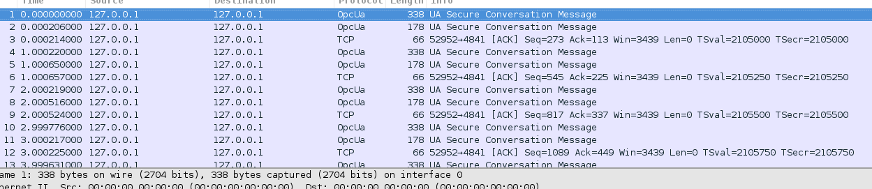

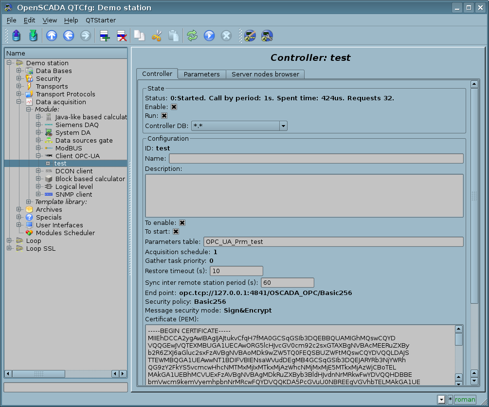

"deviker" wrote:
We used the demostation example and OPC-UA without encryption works. With encryption it doesn't.
We are using the official packages from oscada website for Ubuntu 16.04 ( OpenSCADA v0.8.18 )
APT: "deb ftp://ftp.oscada.org/OpenSCADA/0.8.0/Ubuntu/16.04 ./"
For me that works!
