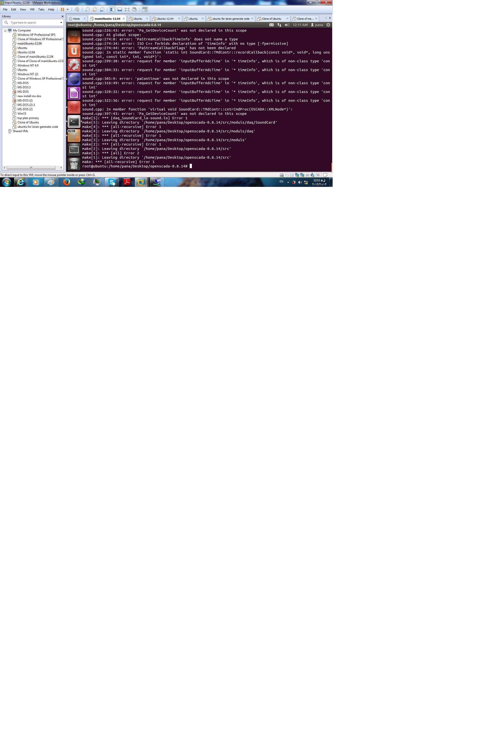

i download original source code openscada-0.8.14 for Linux. i use both openscada-res-0.8.14.tar_3 and openscada-0.8.14.tar. i install it like installation manual. i have error in making step. the picture has been attached shown error in make .
i follow this steps
autoreconf -ivf
./configure
make-->error has been detected.
error in this picture is in sound.cpp
thank you
May be you will start to read?
Are you read the demands for compiling at all: http://wiki.oscada.org/HomePageEn/Function#h737-7
DAQ.SoundCard module
libportaudio Multiplatform library for access to sound controller version 19 and higher.

yes i install all demand in this document. i install portaudio19(http://packages.ubuntu.com/precise/devel/portaudio19-dev) but it didn't work. if each of these demands didn't install , it would make an error in configure step.
the error that i have is in make step no configure step.
do you think this error because of liportaudio??
thank you
