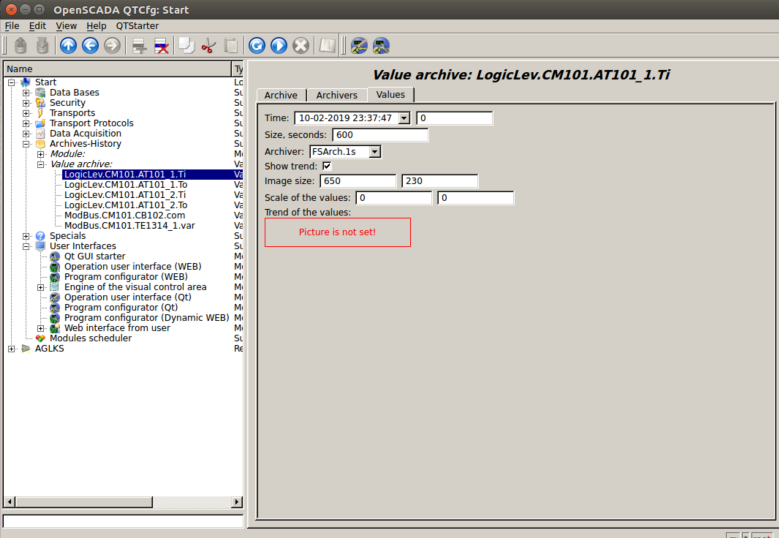

Hello,
I have been following the instruction for quick start in http://oscada.org/wiki/Documents/Quick_start#Archiving-history_of_the_TP_data.
However, when I tried to use "value archive" to "show trend", the program shows that "The picture is not set". I'm not sure if I missed something. Could you please help?
Thank you very much,
Rangsarit
Screen Shot 2562-02-11 at 11.38.06.png (Тип файлу: image/png, Розмір: 157.34 кілобайтів) — 2092 завантажень
This archive-history has no data since not enabled for archiving by the archiver "FSArch.1s" or the Qt-plugin for SVG isn't installed.

Thank you for your fast response. I did try "apt-get install libqt4-svg" in my Ubuntu 16.04 and now the trend line is shown with the values.
Rangsarit
