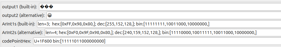

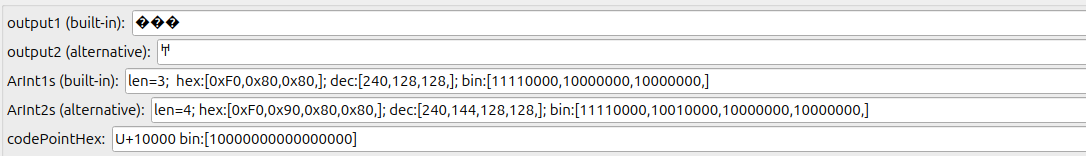

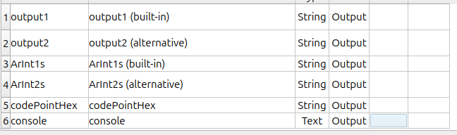

1) on the test 0xD83D indeed both functions (TMess::setUTF8() and setUTF8_new(symb) ) work the same.

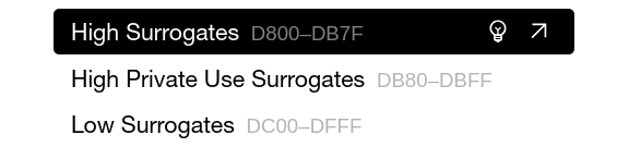

2) but 0xD83D actually can't be converted directly. it is part of a surrogate pair (U+D800 through U+DFFF picture1) and you need to use the following code and apply the formula to them
code1 = 0xD83D;
code2 = 0xDE00;
codePoint = 0x10000 + ((code1 - 0xD800) << 10) + (code2 - 0xDC00);
after that code codePoint == U+1F600. it is smile. pic2. setUTF8_new - correct, SYS.strFromCharUTF - wrong.

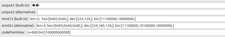

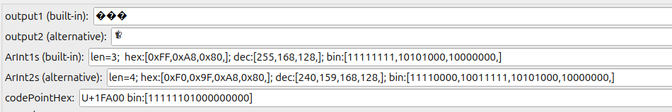

3) I compared the functions and they differ U+800...U+FFF, U+10000...> . Another example is U+1FA00 pic3.
4) function charCodeAt(0,"UTF-8"); is correct in 0...10FFF

codePoint = 0x1FA00;

U 800.png (Тип файлу: image/png, Розмір: 27.38 кілобайтів) — 502 завантажень
Повідомлення створено: 17. 04. 2025 [09:09]
Yes, I see, that is a real problem and I have not struck in that since have not used such codes.
But that is easily fixed for the same code:
string TMess::setUTF8( uint32_t symb )
    string rez;
    if(symb < 0x80) rez += (char)symb;
    else for(int iCh = 5, iSt = -1; iCh >= 0; iCh--) {
        if(iSt < iCh && (symb>>((iCh-1)*6+(7-iCh)))) iSt = iCh;
        if(iCh == iSt) rez += (char)((0xFF<<(7-iCh))|(symb>>(iCh*6)));
        else if(iCh < iSt) rez += (char)(0x80|(0x3F&(symb>>(iCh*6))));
    return rez;
So, now I have:
U+1F600 = F09F9880
U+1FA00 = F09FA880
U+D83D = EDA0BD

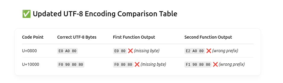

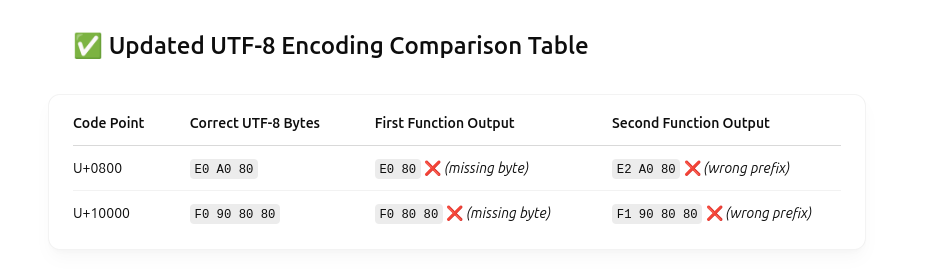

old and new functions will fail U+800 and U+10000 tests. length is now determined correctly, but the first byte is different. gpt chat refers to RFC 3629 limits. and offers code without a loop.
string setUTF8(int32_t symb) {
    string rez;
    if (symb < 0x80)
        rez += (char)symb;
    else if (symb < 0x800) {
        rez += (char)(0xC0 | (symb >> 6));
        rez += (char)(0x80 | (symb & 0x3F));
    } else if (symb < 0x10000) {
        rez += (char)(0xE0 | (symb >> 12));
        rez += (char)(0x80 | ((symb >> 6) & 0x3F));
    } else if (symb < 0x110000) {
        rez += (char)(0xF0 | (symb >> 18));
        rez += (char)(0x80 | ((symb >> 12) & 0x3F));
    return rez;

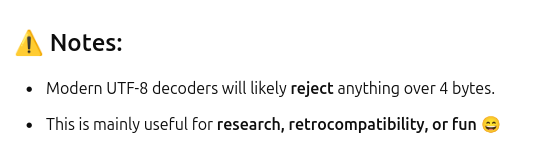

also the chat said that 6 bytes is not allowed by RFC 3629. and is considered unsafe, but code here:

Повідомлення створено: 17. 04. 2025 [12:37]
And that is corresponding with https://en.wikipedia.org/wiki/UTF-8 , which is referring to RFC 3629, so you fix the article! :)
Due to in two and three bytes that well be:
U+800:                100000    000000    — Last code for two bytes is U+07FF
                  11? 100000 10 000000
U+10000:     10000    000000    000000    — Last code for three bytes is U+FFFF
        111? 10000 10 000000 10 000000

Зареєстрован(а) с: 18.11.2023
Повідомлення: 8
it was an elegant function until Arkadii decided to draw smileys in scada. :)
11317
