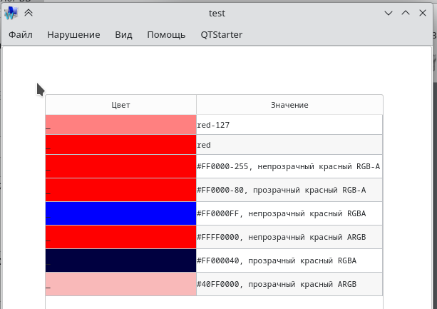

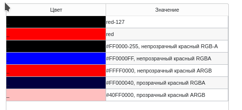

I am attaching an example of a table where this appears and a screenshot.
HTML
<tbl colsWdthFit='1' sel = 'row'>"
<h><s width = '45%'>Цвет</s><s width = '45%'>Значение</s></h>
<r><s color='red-127'>_</s><s>red-127</s></r>
<r><s color='red'>_</s><s>red</s></r>
<r><s color='#FF0000-255'>_</s><s>#FF0000-255, непрозрачный красный RGB-A</s></r>
<r><s color='#FF0000FF'>_</s><s>#FF0000FF, непрозрачный красный RGBA</s></r>
<r><s color='#FFFF0000'>_</s><s>#FFFF0000, непрозрачный красный ARGB</s></r>
<r><s color='#FF000040'>_</s><s>#FF000040, прозрачный красный RGBA</s></r>
<r><s color='#40FF0000'>_</s><s>#40FF0000, прозрачный красный ARGB</s></r>
</tbl>

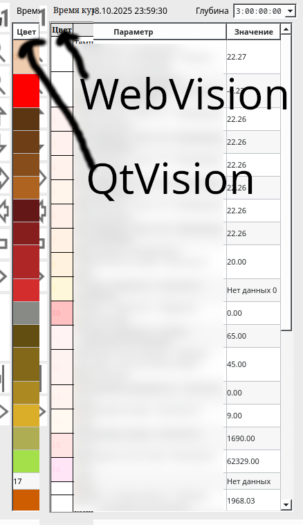

However, as it later turned out, the interfaces in WebVision and QtVision look different, something I only discovered now. I am attaching another screenshot showing the difference in display. The first example showed the working user interface on Qt.

And that is obvious for different visualizers, which smoothing is not a bug fixing also but it is a feature appending.
Your example just show the difference in the extending hex color on Qt and Web, that is the format is not standard in whole and even in Web appeared newly.

As it turns out, the source code contains a function that solves the problem with displaying on the Qt, but it was not used in the code that populates the table cells.
QColor OSCADA_QT::getColor( const string &val )
src/moduls/ui/Vision/vis_shapes.cpp
-- tit->setData(Qt::BackgroundRole, QColor(wVl.c_str()));
++ tit->setData(Qt::BackgroundRole, getColor(wVl.c_str()));
-- tit->setData(Qt::ForegroundRole, QColor(wVl.c_str()));
++ tit->setData(Qt::ForegroundRole, getColor(wVl.c_str()));
This doesn't solve the problem of identical display both on the web and locally, but it's better than before. Bonus: experience building from source.

Yes, I have added of using the standard OpenSCADA function getColor() for transparency here.
And for that I have adapted UI.WebVision for parsing alfa value from OpenSCADA format and placing it to "rgba(red, green, blue, alpha)" in case of hex colors, due to named colors are needed of conversion to hex.
