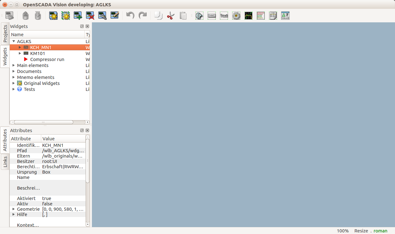

Hi,
I worked through your Quick start.
I have a problem after opening the window of development of the user interface (Chap.3.1), it looks like the enclosed picture, with no graphical elements.
When I start up execution I can see all the elemnts and it works fine, but not in the developing window.
I tried with two different PCs (Ubuntu 16.04 and Ubuntu 18.04).
Do you have any ideas?
Best regards
Martin
There is no problem on this screen, may be you need to open for edit this frame-widget for get it in the main field of the opened frames, of Figure 3.1.3?

now i've got it.
No double-click on the widget, but "edit visual item" from the context menu.

Control + E is the keyboard shortcut for this.
