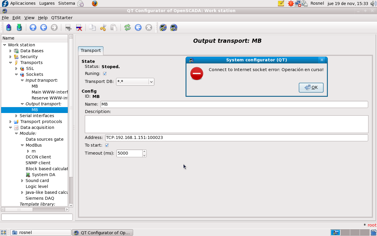

Hello, i'm Rosnel Martínez from Venezuela.
I'm trying to test the Modbus protocol, and when I connect a device and configure the "socket" for input and output module "trasports" failed to establish communication. I do this and then run a "Data Acquisition" module "modbus" using the TCP / IP using the "socket" previously configured.
The error says "Operation in progress" and not allow the connection or establñecer the test of "Data Acquisition".
Annex a picture of the error and socket configuration.
Can you help me?

Maximum count of port 65535.
100023 - ???

2 Rosnel,
see http://en.wikipedia.org/wiki/List_of_TCP_and_UDP_port_numbers
set default port number is 502 (for Modbus TCP/UDP)

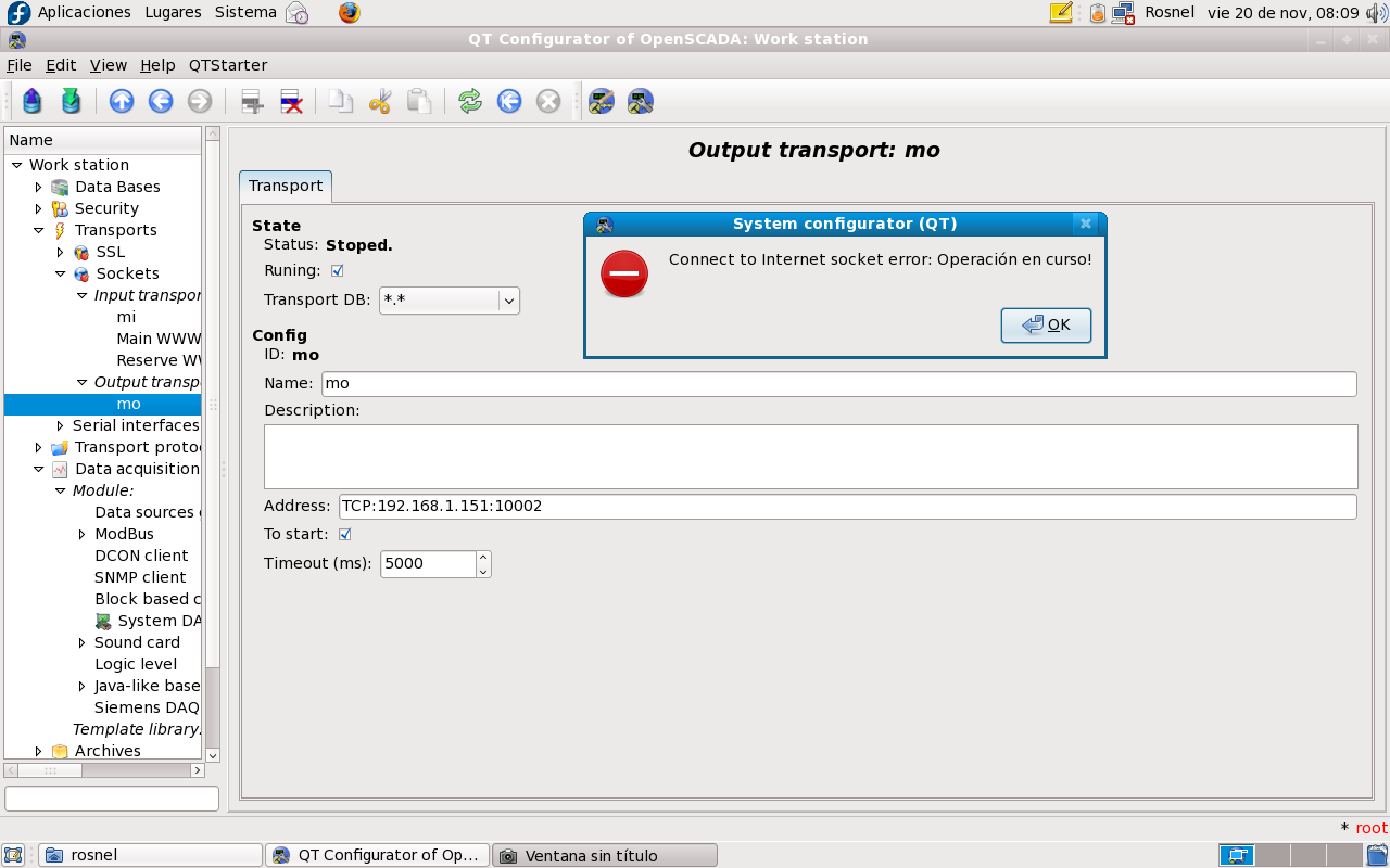

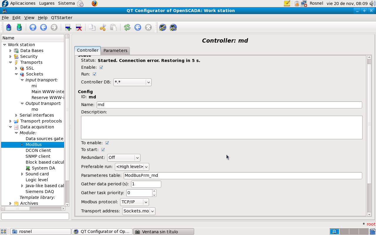

Thanks for the quick response.
you're right, I'm wrong in writing.
Testing with the 10,002 port which is open and the error still persists. Annex image error and the Data Acquisition module
And I'm sure that the device supports Modbus because the test is to make the comparison with LabView for Data Acquisition
