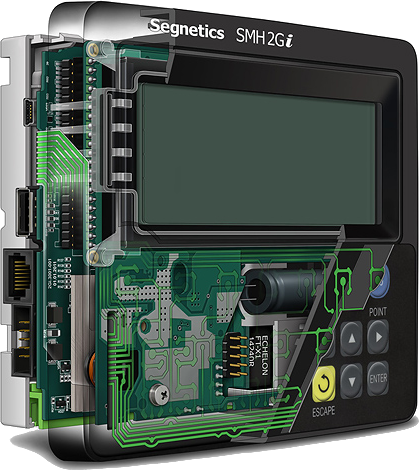

[TaskDone] New module DAQ.SMH2Gi creation for deep integration to Segnetics SMH2Gi
Сообщение создано: 24. 09. 2012 [10:02]
Сообщения: 3799
Base: Order and hardware from "Laboratory of vacuum technologies" (http://e-beam.ru), Vasily Grigoriev
Funding: available
Begin: 10.08.2012
Priority: high
State: Done
Project page: http://wiki.oscada.org/HomePageEn/Doc/SMH2Gi
Hardware: Segnetics SMH2Gi
(+) The module creation.
(+) Cooperate with original execution environment "SMLogiсs" by shared memory variables.
(+) Segnetics internal protocols MR and MC realizing.
(+) Final testing to physical signals flow:
- MC AI, DI read: pass
- MC AO, DO write: pass
- MR DI read: pass
- MR DO write: pass
(+) Document and translation preparing
