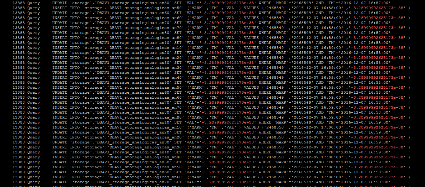

With respect to the second point, my first conclusion was just that mysql modified the value, but after verifying the queries (enable log logging on the server), I verified that the data was wrong. I registered the queries that the openSCADA sends to the mysql db and I verified that it is the openSCADA that sends the erroneous data (-3.28999992625173e + 38).
I think it may be due to an error converting float to string to generate the sql string.
If I put the value "by hand" it registers without problems in the db mysql.
