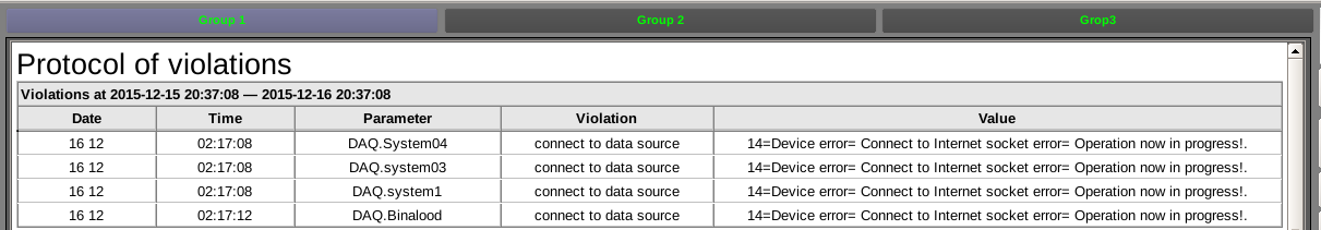

Hi. I have a question.
in part of Documents in "Protocol of Violations", by rule "1:al*:*" All rows are displayed, But I want to show only the lines that the column value of "Parameter" have certain value for example just "plc2".
How can i wrote a Condition?
How do you need and write, see to the OpenSCADA messages archive for understand, like this:
"1:/plcK7:al[^:]+:[^_]+_1/"

Thank you Roman
in The photo was taken, I want to show only "DAQ.System03" in "parameter" column. how i filter "DAQ.System03" by change rule "1:al*:*"?
