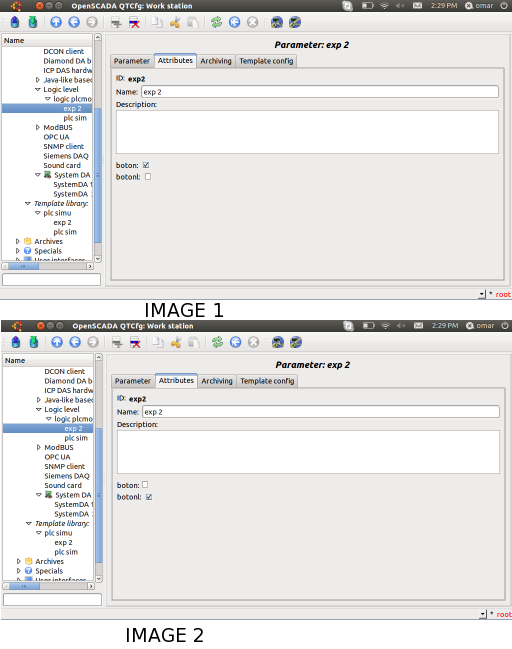

Dear friends,
I little question, I create a so basic template to , on – off a indicator by the logic level:
if (bot == false) botl=false;
else
botl=true;
bot ( boolean, input, full access, public constant )
botl ( boolean, output, read only, constant )
when I check the parameter that use this template at logic level, and “click” the bot ( boton), it's supposed that the botl ( botonl) have the same state !,
results expected
if bot “on”------- then ( botl “ on”)
if bot “off”------- then ( botl “ off”)
but that not happen!, ( see image 1 & 2).
results obtained
if bot “on”------- then ( botl “ off”)
if bot “off”------- then ( botl “ on”)
do you have any idea about what I must to set, to obtain “real time” equality between the “bot” and “botl”on the parameter at logic level?.
I know it is so basic, but it don't work!. What i am doing wrong?.
Why do you use "public constant" and what into "Template config" tab about that?
I do not see that attributes on your image!
I have not any like problems. Write template correct and see examples into DemoDB!
