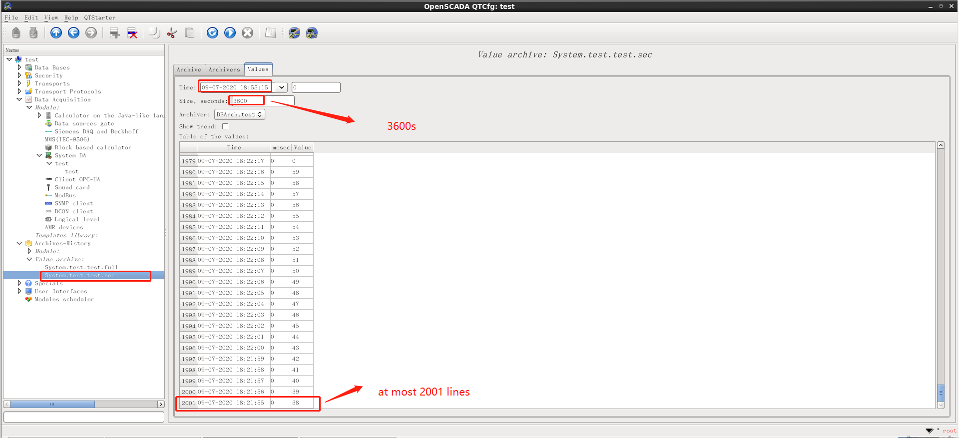

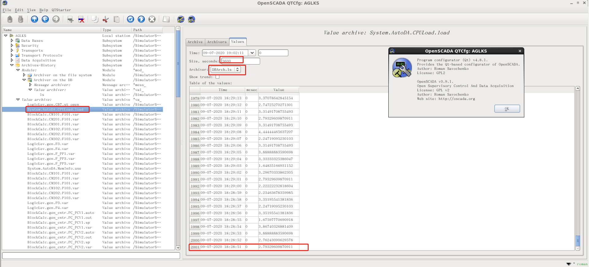

It is only displayed at most 2001 lines by the "Value archive" module of the "Archvies-History" subsystem itthe vesion of OpenSCADA0.9.1-3LTS.There are more than 2001 rows in the database.
The os of my computor is CentOS6_x64.
How to solve the problem or avoid the problem?

That is not a bug but just a limit of diagnostic viewing the value archives in 2000 points!
That is not principal essence and it is not operative interface and even the operative interfaces has own limits, which configurable ones mostly.

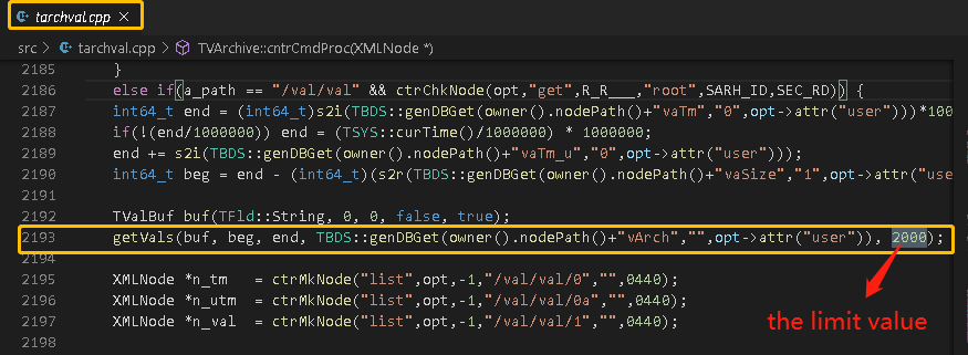

From the source code, I found the limit value.
I think it's better to increase the limit value, e.g 3600*24.
It's just a suggestion.
