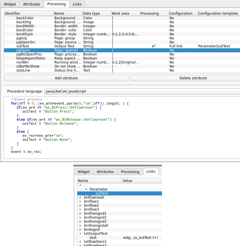

Could somebody point me to description how "input" and "output" variables are defined for javalike processing in visual develop engine?
In "Calculator on Java like language" it is IO table where variables defined but in visual processor is no such table. Was thinking that attribute names of the widget serves as variable names - but when tried this - it not works.
For example created widget box, added string attribute "outText" and put the code to assign some value to it. Then Linked this attribute to a text field to see it value - but code seems to do nothing. Value is allways <EVAL>. Screen attached.
Anybody could point me to example or clear description how variables are passed in and out to visual processing code? And when this code is executed? In certain intervales? Or on some evants?
In AGLKS example I see only manipulations with visual items, while I want to find out how to read/write values to block calculator registers on ButtonPress and so on.
http://oscada.org/wiki/Special:MyLanguage/Documents/Quick_start#ComplexWdg
http://oscada.org/wiki/images/8/80/Vision_wdg.png
Just append parameters: http://oscada.org/wiki/Modules/BlockCalc#Parameters_of_the_controller
