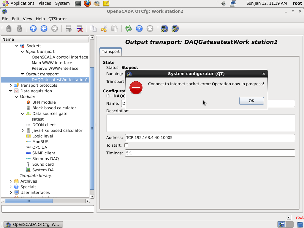

an output transport is made when DAQGate was configured. but when I want to change the status of transport of "Work station2" to running, it show me an error:
"connect to internet socket error: operation now in progress!" :(
and therefore it remains stopped and I have an error in DAQGate controller of "Work station2".
Remote host 192.168.4.40 unavailable into your network or port 10005 here closed or OpenSCADA here stopped or input transport on 10005 port no present into remote OpenSCADA.
I check these thing you mentioned. this is the result:
-I can ping "work station1" to "work station2" and vice versa.
-before trying to test DAQGate, firewall and security software are closed and disabled in order not to block the traffic.
-DAQGates of both stations are running. ("work station1" can read their own data and transport module shows the amount of transmitted data)
-in both stations, their default input transport is running without any error. its address is TCP::10005:1 .
unfortunately I don't know what to do to solve the problem. :(

I do everything you said. but I still had the same problem. Finally I find out that Centos is blocked 10005 port, so after adding this port to its firewall the problem is solved and every thing is OK now.
