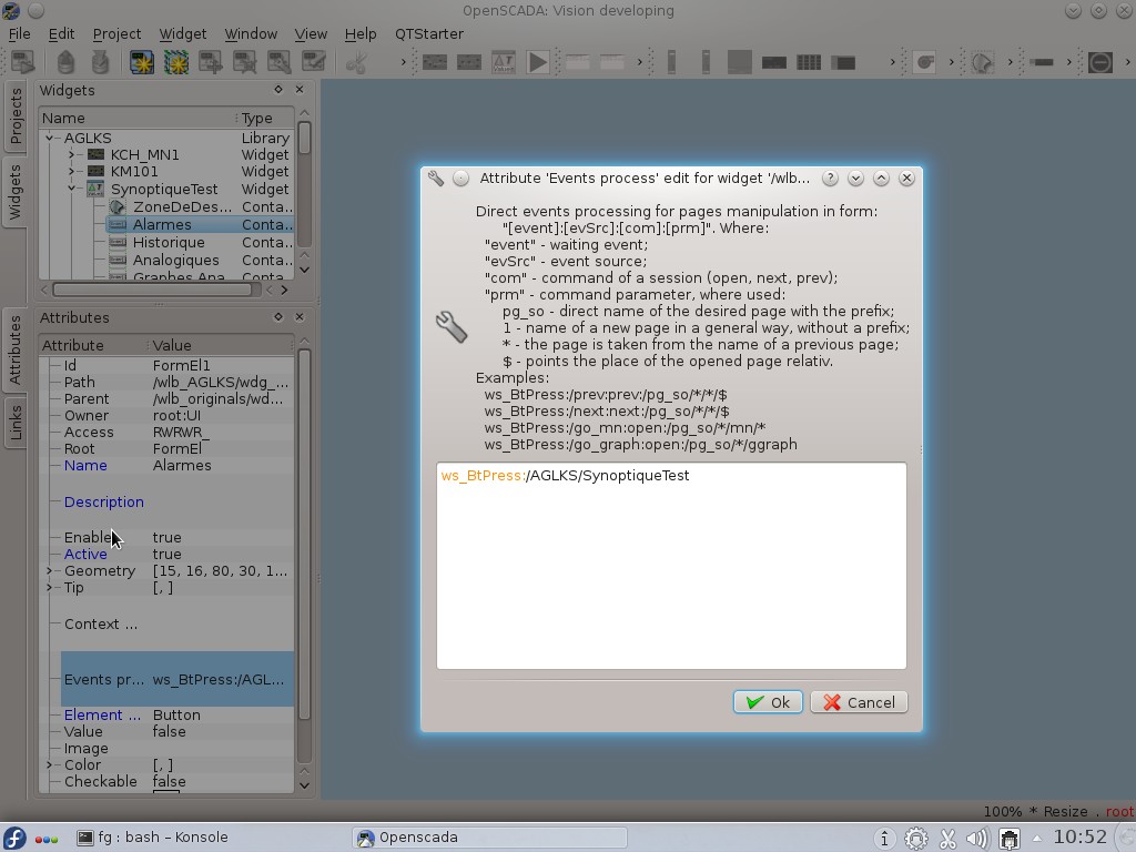

See attachment file. I've a "Alarmes" button on my first window "SynoptiqueTest". And I would like to open an other window (for example here, "KCH_MN1").
This is the good path ?
Where I put the code to open another window ?

"fgdevel" wrote:
Anyone ?
Read documents and learn examples into DemoDB.
All the questions there described!
