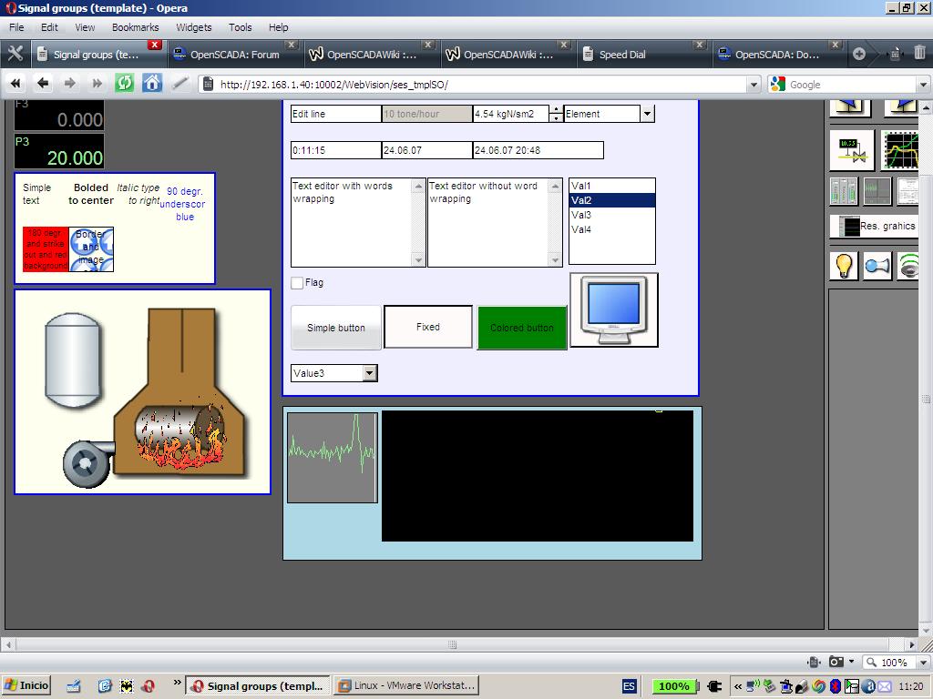

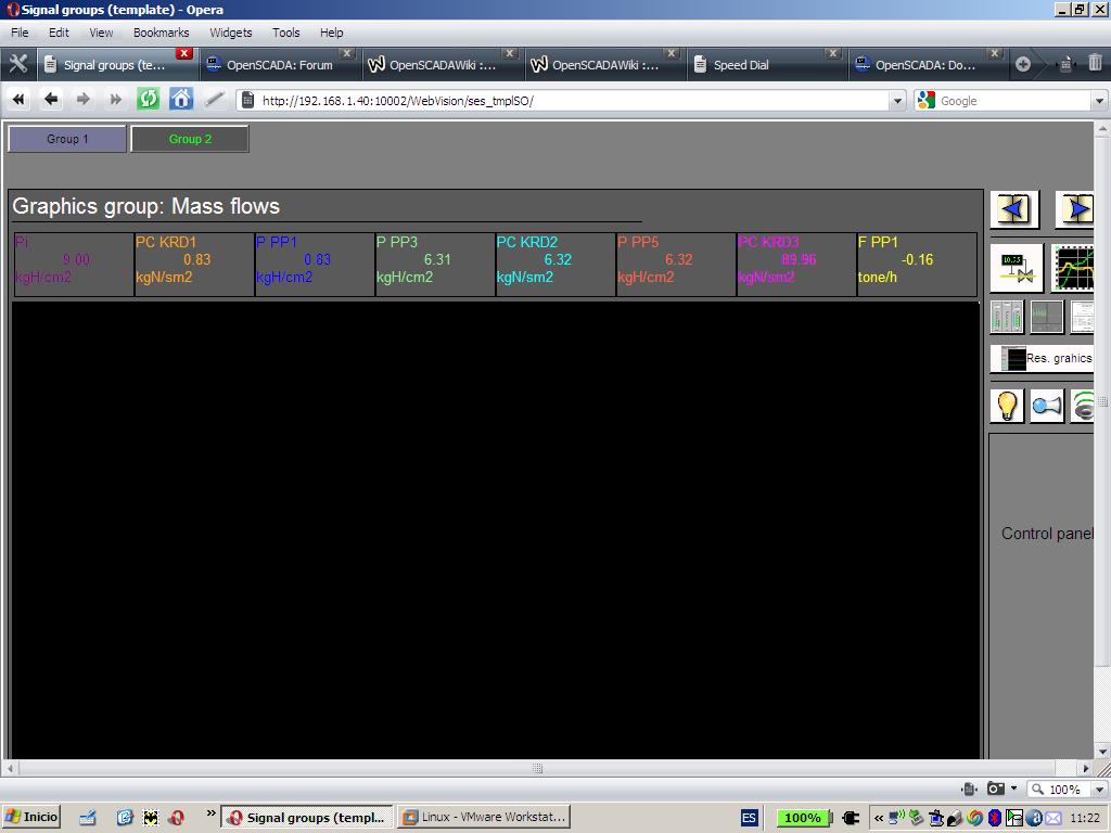

Hi. I've built Oscada, in Debian (lenny) and Ubuntu (Intrepid), both 0.6.3.3 and SVN version, and there is always a problem with some Trends in WebVision.
I attach two pics and a list of libraries I am using to build Oscada.
It looks like a problem in image PNG conversion to Web, because in the top it appears a little of de graph as you can see in pics.
What the problem could be?
Thx.
Maybe trend size is set to zero. And your started configuration is no Demo-DB and no data for trends present. On Opera all Web tested and work fine.
Hi, Roman.
No, it is not a trend size issue, I can see trend OK in Operation user interface – QT, but at same time in Web is wrong. And yes, it is Demo-DB, and it is not a browser problem. (With Fedora 11 and precompiled packages all is OK, the problem is with Debian and Ubuntu, there is not precompiled packages and I use SVN or 0.6.33 to compile it).
If you see above the image "webvision.jpg", on top there is a bit of graph and it is moving left. It seems like an error in algorithm to convert images to webvision, perhaps a problem due to library versions or similar, but I don't know.
From this image I see what you open not "Demo" project but "Template" project and model data broken and not present, see to F3 and P3 on top-left.
Possible you call several OpenSCADA process, one on daemon and second on graphical. Or installation is broken.
I made testing for English and Opera on Windows - All work fine.

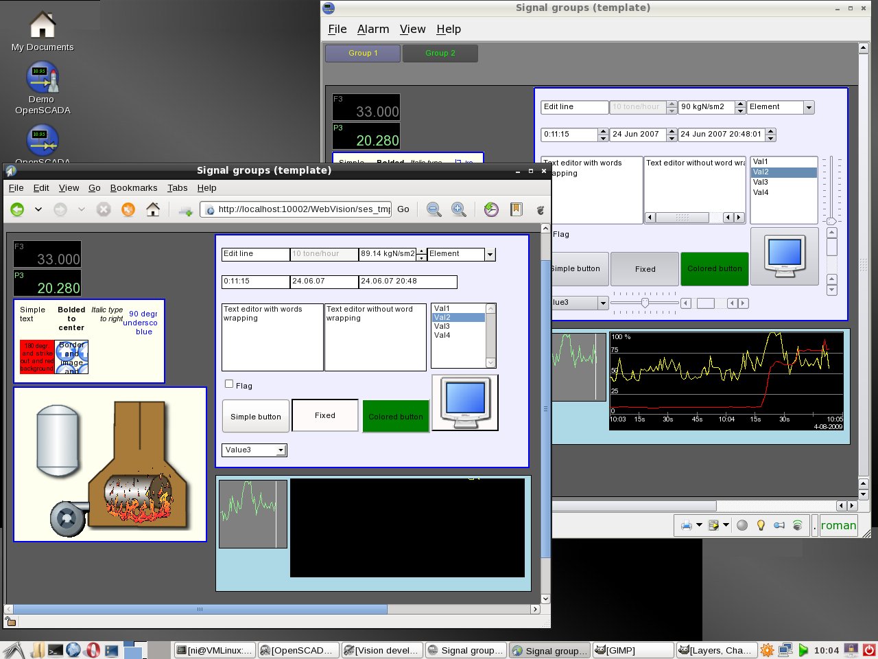

I send a new pic. Oscada SVN running on Linux Debian, it shows at same time operation user interface QT and Web (Firefox). You can see how in web trend only is visible upper graph, a bit.
Сообщение создано: 04. 08. 2009 [11:55]
Сообщения: 3797
Please see to DOM-inspector for image parameter. I have not this problem anywhere.
LibGD2 which version?
Images is created by libgd. Into LibGD2 problem perhaps.
Image size is OK, but almost black.
[code]
http://localhost:10002/WebVision/ses_tmplSO/pg_so/pg_1/pg_mn/pg_1/wdg_diagTests/wdg_tr2?com=obj&tm=865&xSc=1.00&ySc=1.00
[/code]
Curiously the graph on the left in the image is OK. What's the difference?
About versions...
Debian 5.0 Lenny and Ubuntu 8.10 Intrepid (problem) are using:
libgd-noxpm 2.0.36
qt4 4.4.3
fftw 3.1.2-3.1
Fedora 11 (no problem in it) is using:
gd 2.0.35
qt4 4.5.1-13
fftw 3.2.1-2
Perhaps changes in libgd last version 2.0.36?
