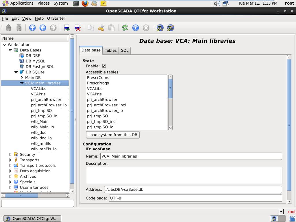

I tried again, but I didn't see any save button.
Screenshot of my settings is attached here.
After closing the software, the DB will be disappeared.
Written on: 11. 03. 2014 [13:05]
snowboy
saman ahmadi
registered since: 14.09.2013
Posts: 13
Now I understand why I don't see save button.
After adding new DB, if we use "Load system from this DB" button, we can't see any save button in OpenSCADA. In this condition "ctrl+s" also doesn't work.
Therefor I conclude that we must save DB before load system from it.
So the problem is solved
Thanks for your attention :)
