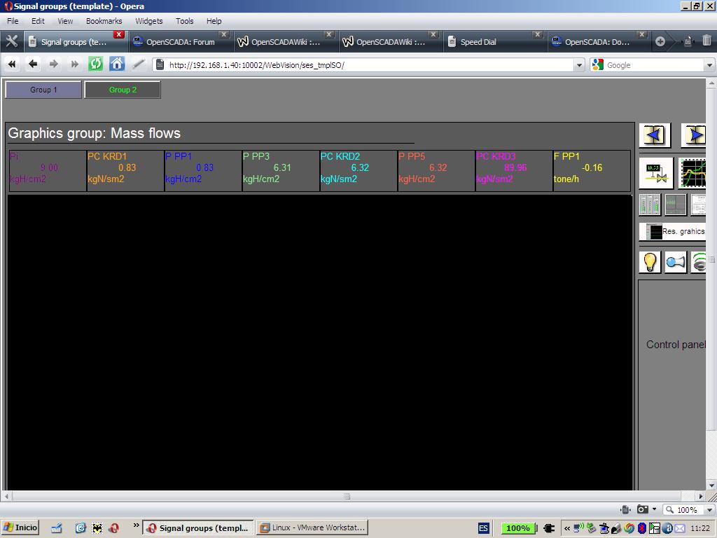

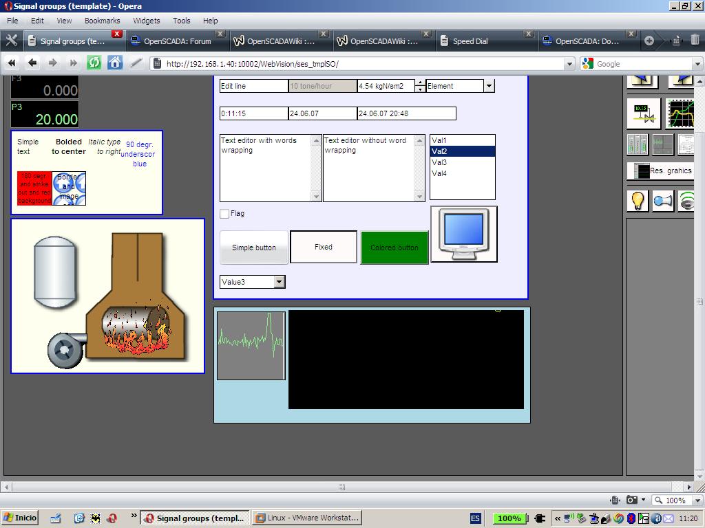

Hi. I've built Oscada, in Debian (lenny) and Ubuntu (Intrepid), both 0.6.3.3 and SVN version, and there is always a problem with some Trends in WebVision.
I attach two pics and a list of libraries I am using to build Oscada.
It looks like a problem in image PNG conversion to Web, because in the top it appears a little of de graph as you can see in pics.
What the problem could be?
Thx.

No, it is not a trend size issue, I can see trend OK in Operation user interface – QT, but at same time in Web is wrong. And yes, it is Demo-DB, and it is not a browser problem. (With Fedora 11 and precompiled packages all is OK, the problem is with Debian and Ubuntu, there is not precompiled packages and I use SVN or 0.6.33 to compile it).
If you see above the image "webvision.jpg", on top there is a bit of graph and it is moving left. It seems like an error in algorithm to convert images to webvision, perhaps a problem due to library versions or similar, but I don't know.
Written on: 03. 08. 2009 [11:36]
From this image I see what you open not "Demo" project but "Template" project and model data broken and not present, see to F3 and P3 on top-left.
Possible you call several OpenSCADA process, one on daemon and second on graphical. Or installation is broken.
I made testing for English and Opera on Windows - All work fine.

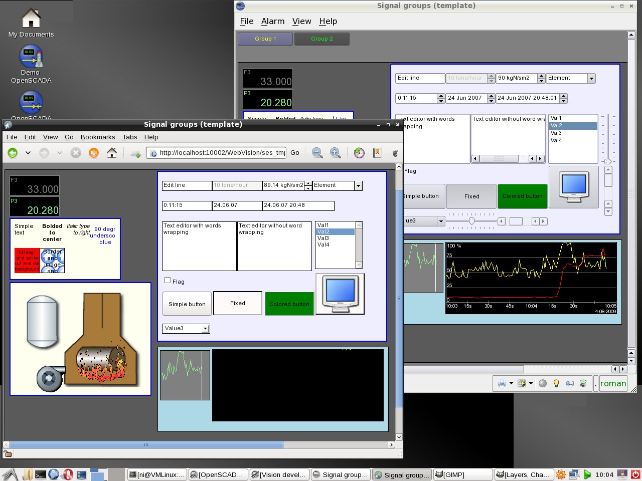

I send a new pic. Oscada SVN running on Linux Debian, it shows at same time operation user interface QT and Web (Firefox). You can see how in web trend only is visible upper graph, a bit.
