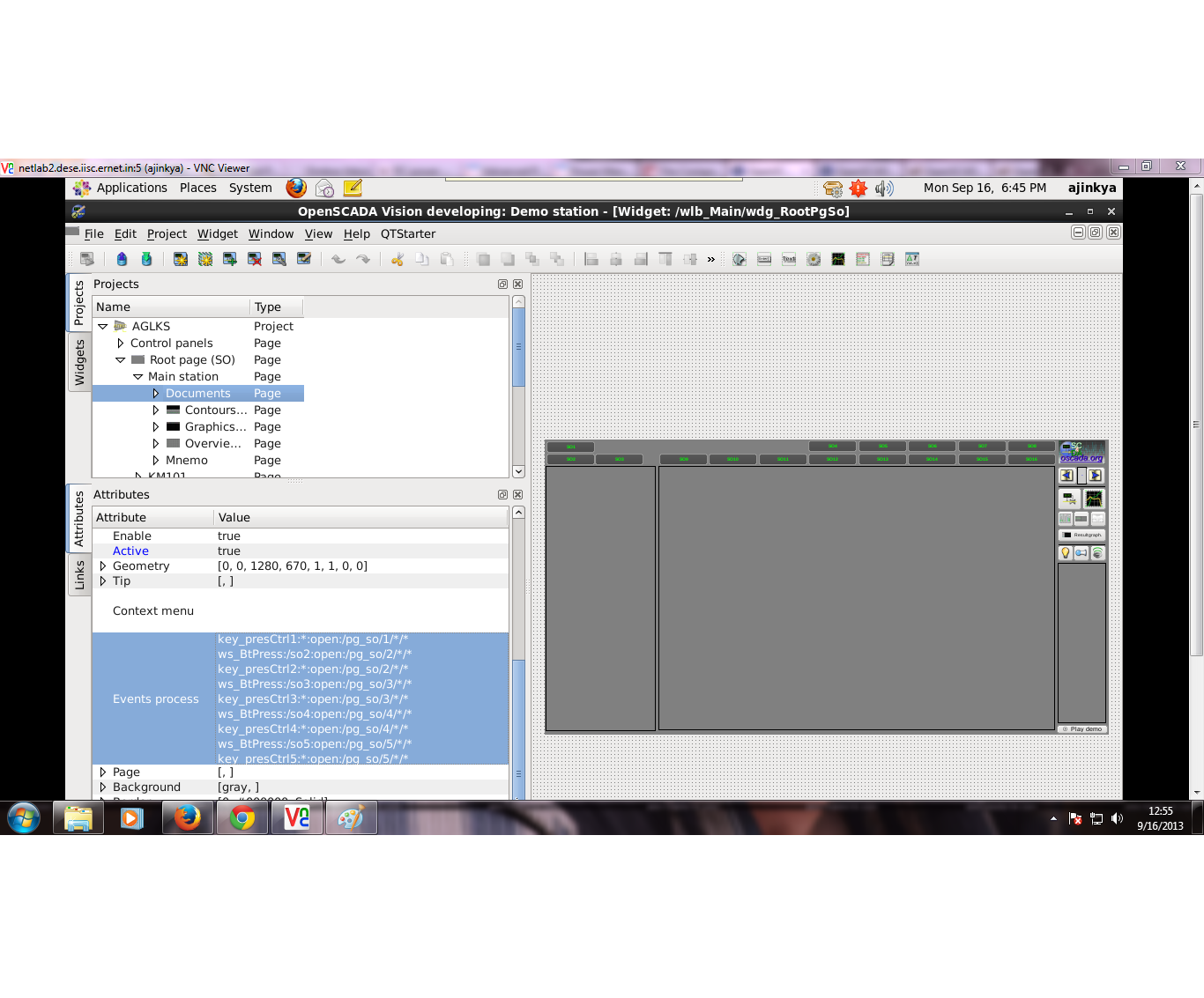

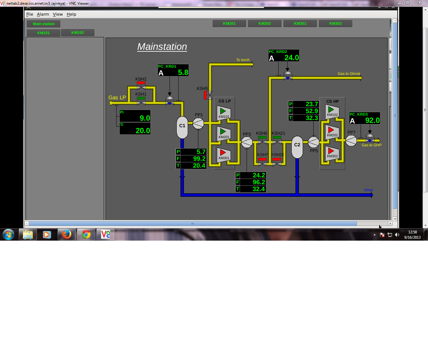

Hello Sir,
I need to add one more widget box to root page(so).
I have added it. Currently playing with AGLKS demo only.
But in programming what all changes required in following-
1. Procedure play demo
2. Event process
3. Process in properties of Root Page(so)
I tried to modify "3. Process in properties of Root Page(so) " could manage the front end to the user to some extent,
still could not get it as expected.
And how to link the widget box with the different pages? say "Memo" page.
Like in root page there is one widget box named - "pgCont" which is linked to various pages in root page(so) i.e. (document, memo, contours, graphics)
kindly have a look a the screenshot, to have an idea.
Thank you :-)
widget box question.png (File type: image/png, Size: 283.81 kilobytes) — 2602 downloads
after_project run.png (File type: image/png, Size: 237.16 kilobytes) — 2696 downloads
Written on: 16. 09. 2013 [18:00]
You should:
- set attribute "page:group" to some self value, for "pgCont" that is "so" and for "infoW" that is "cntr";
- set the group for all your pages which needed for include to the box;
- prepare the pages call mechanism, by some button or other events.

I had done that "page:group" assignment earlier for the new "wdg_Box" named pgCont1.
The actual question is how to divert few pages say - Mainstation, KM101, KM102 on pgCont
and the remaining KM201, KM202, KM301, KM302 on newly created "pgCont1".
Both pgCont and pgCont1 should be assigned to the same page:group as "so", right??
As i have assigned both of them to page:group "so".
But it does not help,
at a time, only one of the "wdg_Box" (either pgCont, pgCont1) are displaying the respective pages on button press.
Written on: 17. 09. 2013 [13:18]
What is the group value? The value have to different from "pgCont" and "infoW".
You have not to direct present you have to create new and set for its group like for "pgCont1".
No the group value for the conainers have to specific!

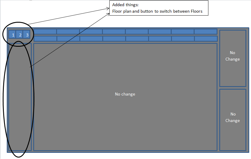

Thank you sir,
It means I have to assign different page:group to each wgt_Box in Root Page(so).
I have gone through ElCadr widget in Projects tab which is assigned to "cntr" page:group,
and the things on ElCadr get displayed on infoW area.
So you want me to create some thing like ElCadr which will display the required things on pgCont1. right?
What I should do in order to get the Root page format as shown in the image attached? I mean from attributes setting and programming point of view.
I want to display floor plan (in the big encircled part on left hand side) on respective floor button pressed (1,2 or 3).
Is it possible?

Written on: 18. 09. 2013 [12:02]
Yes, it is right.
For buttons 1, 2 and 3 you should append events processing to RootPage for open the pages related to the buttons and into group of pgCont1.
Is it possible?
You have to set need background for the pages behind the buttons 1,2 and 3. So you should have different pages for each button.
