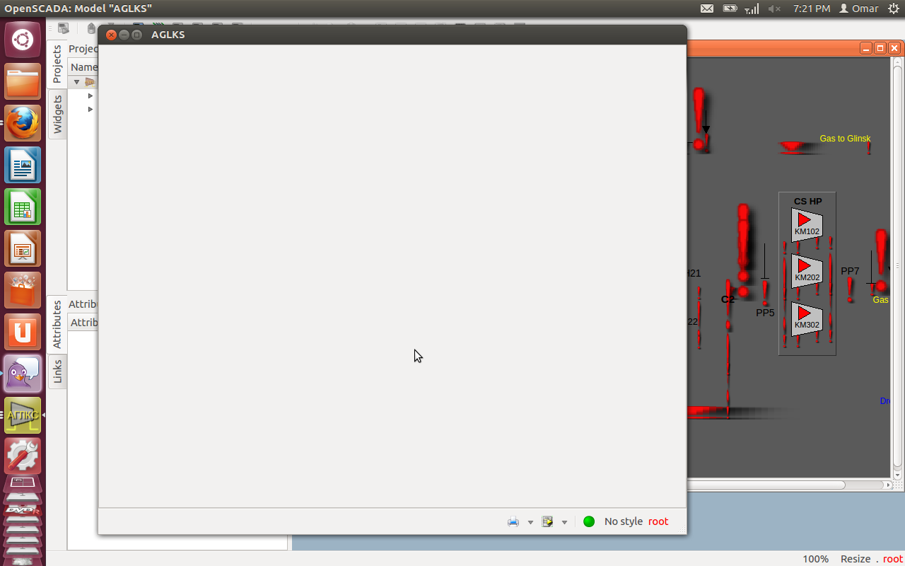

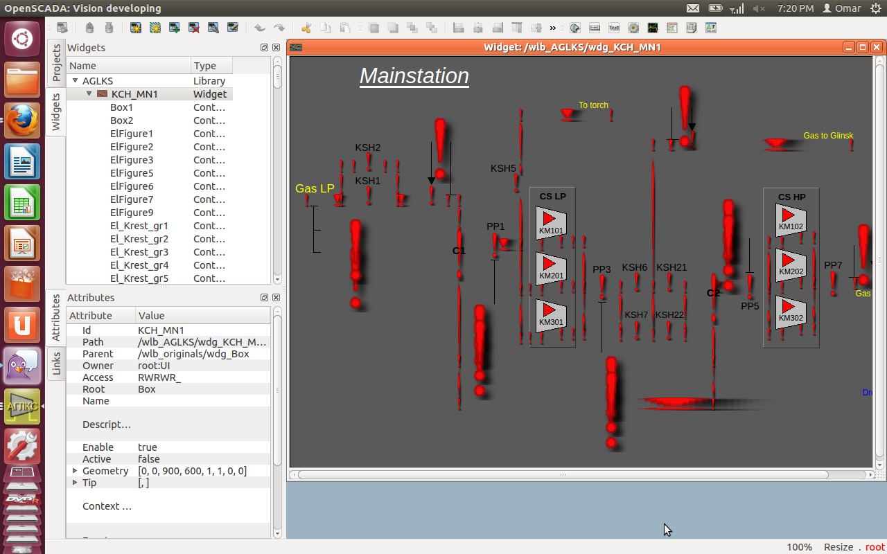

My problem is that when I try to run the aglks and boiler process the screen do not show the controls and visual components that usually shows, ( see images ).

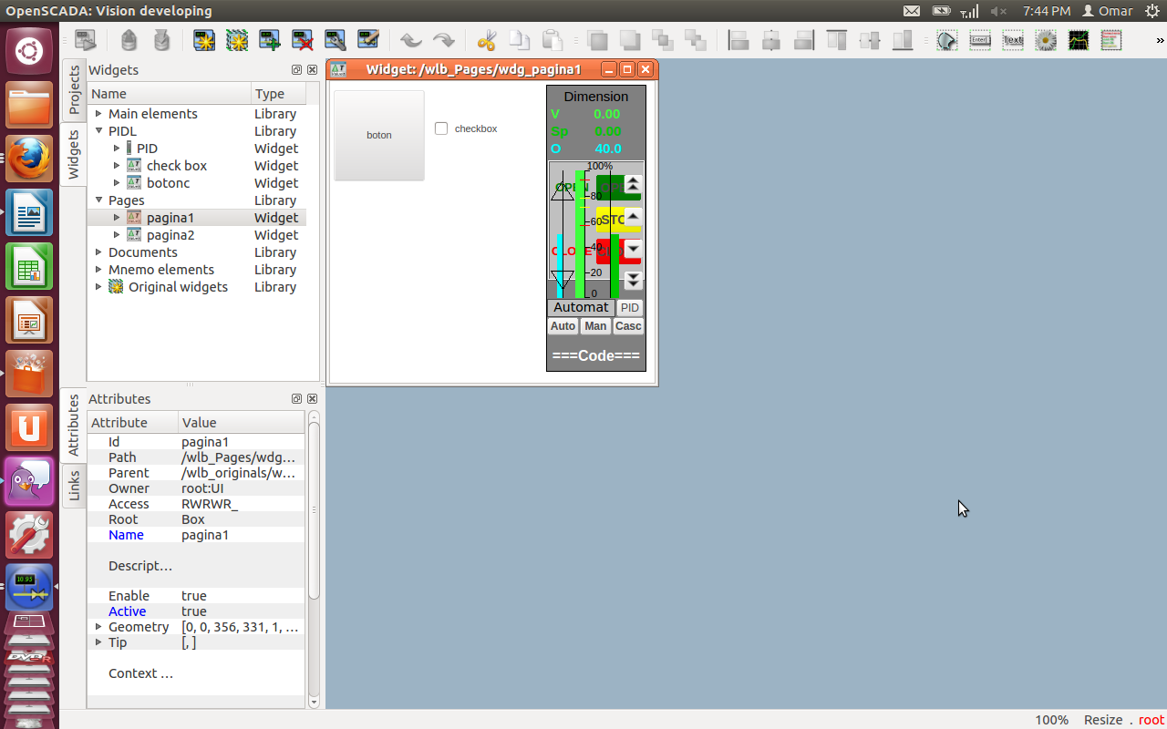

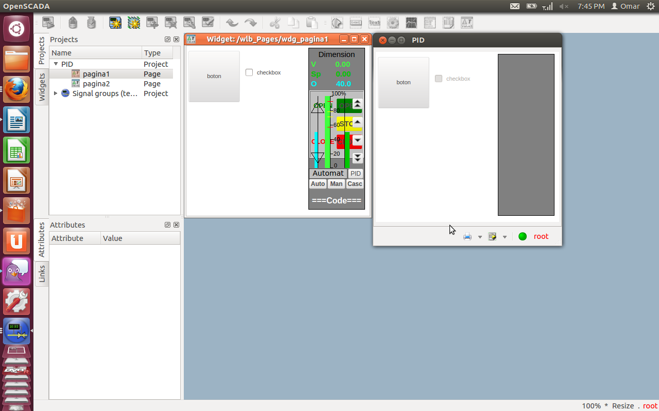

Also in the works station when I add a common pid controller and after try to view it in the project execution can't see the buttons of the controller ( see images ), any idea, where is my mistake, thanks a lot for the support.

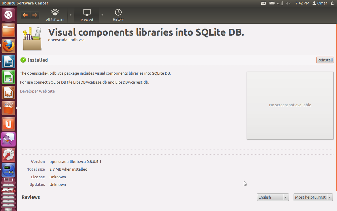

PD: I have also installed the VCA library.. ( see images ).
I have not like problems also on Ubuntu 11.10 and 12.04. And version 0.8.0.5 clean tested into LiveCD/USB.
Try remove or save somewhere directory ~/.openscada and next start AGLKS or Boiler model. Also place here errors into console or OpenSCADA system messages from here: http://wiki.oscada.org/Doc/OpisanieProgrammy/part4/files?get=subsys_arch_mess.png
P.S. Generically VCADB structure into 0.7.0 and 0.8.0 some incompatible.

Try to completely remove OpenSCADA deb packages by using the Synaptic. Or
sudo apt-get remove openscada
And reinstall it.
For 32-bit systems
sudo dpkg -i openscada_0.8.0.5-1_i386.deb openscada-libdb.main_0.8.0.5-1_all.deb openscada-libdb.vca_0.8.0.5-1_all.deb openscada-model.aglks_0.8.0.5-1_all.deb openscada-model.boiler_0.8.0.5-1_all.deb openscada-doc.en_0.8.0.5-1_all.deb openscada-doc.ru_0.8.0.5-1_all.deb
For 64-bit systems
sudo dpkg -i openscada_0.8.0.5-1_amd64.deb openscada-libdb.main_0.8.0.5-1_all.deb openscada-libdb.vca_0.8.0.5-1_all.deb openscada-model.aglks_0.8.0.5-1_all.deb openscada-model.boiler_0.8.0.5-1_all.deb openscada-doc.en_0.8.0.5-1_all.deb openscada-doc.ru_0.8.0.5-1_all.deb
All packages available
http://www.oscada.org/oscadaArch/0.8.0/Ubuntu/12.04/

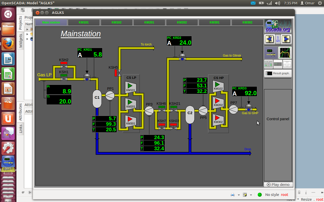

Ok, I follow the instruction of Roman and the result was successful, after run the AGLKS and the Boiler ( both works right after delete the directory ~/.openscada.)
Then i close the models, and run the Openscada workstation, after that I load the lib VCA located in the directory /.openscada/LibsDB
I will to do more tests and report any abnormal behavior.
