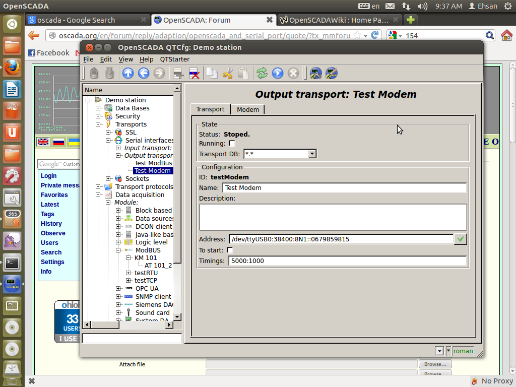

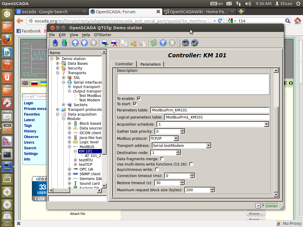

Hi roman and thanks for the answer. See I have got this far (step by step)
1- sudo openscada_demo (sudo to have access to serial ports)
2- I open the Demo Station
3- Under Data Accquisition I select Module and then ModBUS and then choose KM101
4- I set the Transport Address Serial.testModem
5- Then I go to Transports and under serial interfaces and Output transport I select "Test Modem"
6- I set my device address in the Address field and do not change anything else
it will be in fact:
/dev/ttyUSB0:38400:8N1::0679859815
my device is a HUAWEI GSM Modem which I have communicated with it via serial port previously and is working. The only thing I want to do is to send two bytes "A" and "T" to this modem and recieve its response (which is "O" and "K" I think).
7- I check the "Running" checkbos for the "Test Modem" and the program crashes...
I will be thankful if u can tell me exactly what further step should I take in order to recieve the data bytes... and please tell me step by step... I can not figure what your docmuntations are all about (sorry)
attached I have put screen shots of my configurations
Thanks in advance
Why? You need configure permit to the serial devices.
it will be in fact:
On your screen shot you do not applied the address!
And why my telephone number left?
What OpenSCADA version used?
On OpenSCADA work version I have not any crash.
Send me crash report: http://wiki.oscada.org/HomePageEn/Doc/CrashReport

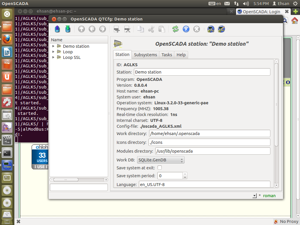

Written on: 20. 12. 2012 [16:27]
citrizin
Abolfazl
registered since: 04.10.2012
Posts: 19
Hi Ididnt know that was your number and I dont know what to put there instead?! may u tell me what to put there?
u can check the version in the screen shot, but I downloaded the whole program just a month ago
I guess thats not a bug but a problem with my configuration. may u tell me how to configure it for my purpose? I just need to send bytes and recieve the response.
thanks
Screenshot from 2012-12-20 17:54:30.png (File type: image/png, Size: 240.87 kilobytes) — 2531 downloads
Written on: 20. 12. 2012 [18:59]
This is 0.8.0.4 LTS and on it version the Modem mode work fine also.
I have test the Modem mode and all work fine for me. Also I have add print modem connection process to console and the messages archive: http://wiki.oscada.org/HomePageEn/Doc/ProgrammManual/part4/files?get=subsys_arch_mess_en.png , for work version.

Written on: 20. 12. 2012 [19:22]
"citrizin" wrote:
you mean I was right about the configs?
Path to serial device and Telephone number set correct for self.
Next establish the connection, by set "Running".
Next into appear tab "Request" http://wiki.oscada.org/HomePageEn/Doc/ProgrammManual/part4/files?get=subsys_tr_mod_tr_otr_req_en.png write and send your bytes.
And carefully read the documentation before next questions!
