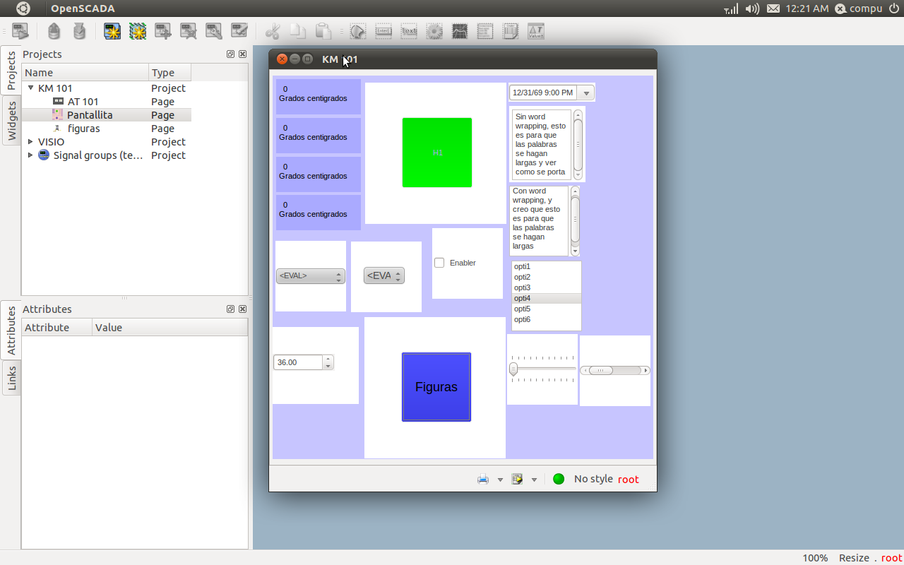

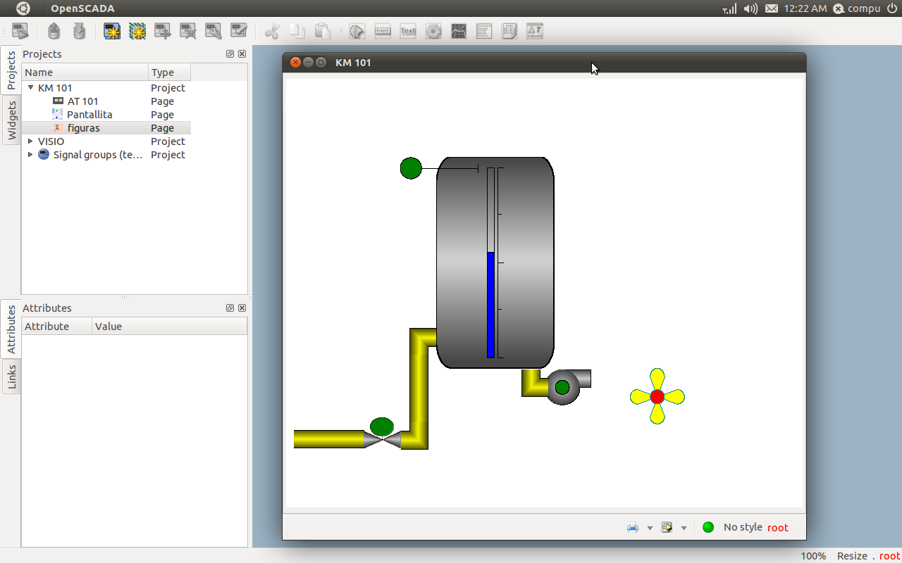

I need to learn to link the different pages of a project , so as I understand it is done by the use of the processing of events, I want to do something basic, I want to open a project page (see image: page 2) by “click “ a button ( Figuras ) on the Main page ( see image: page 1).

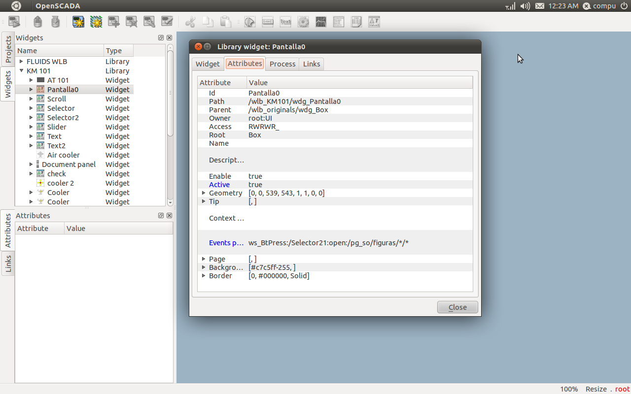

I have the follow code inside the event processing
ws_BtPress:/Selector21:open:/pg_so/figuras/*/*
But, where I must enter it:
In the Event processing of the page inside the projects tab?
or
I the Event processing of the widget inside the widgets tab? ( see image : page1-widget )
But I really don't found the way to open a new page by just do click on the Main page of my project, so my request is, do you have some example about how to do it?, could you guide me where to review this configuration?
See to DemoDB for "Control panel" call from different frames and widgets.
Thanks a lot.
See to DemoDB for "Regulator's control panel" processing click into frame for "Control panel" call.
