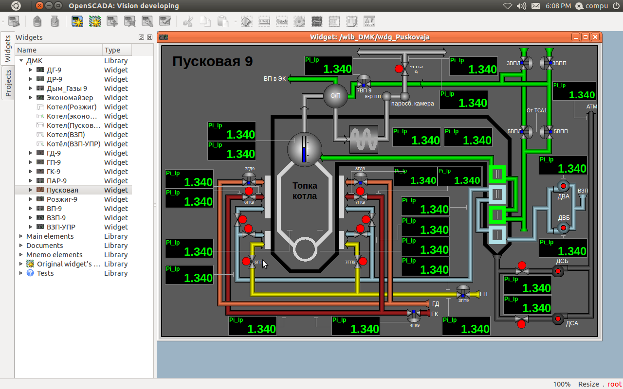

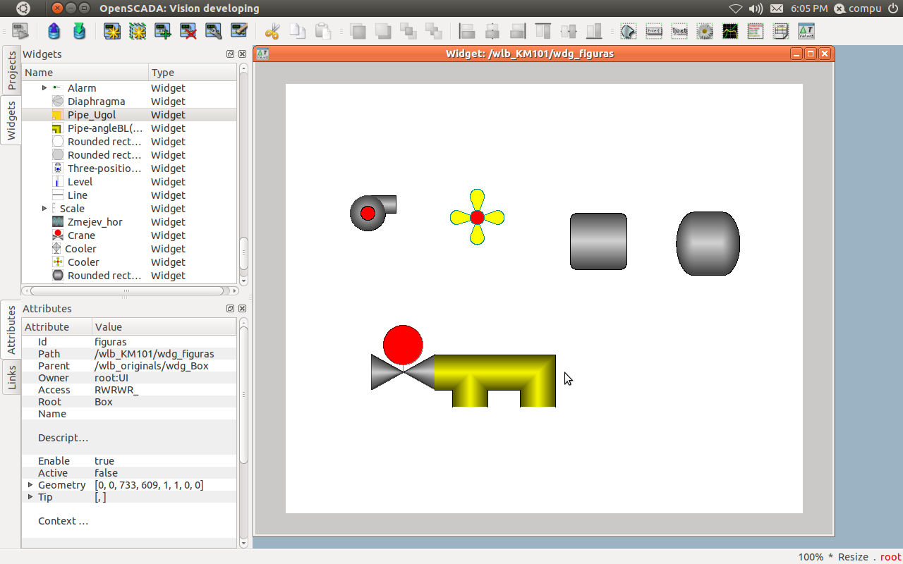

Hello i want to create a GUI of my local technological process so I need to add visual components like
pipelines, cranes, valves, etc.
I know that in OpenScada there are widgets ready to use, and I want to use those on my GUI, but I need to know how can I resize the pre-ready widgets to fit a size optimum for my technological process screen, see the attached images as example.
For example how can I reduce the size of the pipe, valves ( picture 1 ) to looks like the pipes, valves of the ( picture 2 ).
Thanks a lot.
Picture A.png (File type: image/png, Size: 138.32 kilobytes) — 3120 downloads
Picture B.png (File type: image/png, Size: 193.02 kilobytes) — 3185 downloads
Taken from QuickStart manual:
HTML
The added elements can be subsequently positioned as needed by simply selecting and dragging them by the mouse.
Also you can change its size. Simple size changing will only resize the container widget geometry, what often needlessly.
For all widget's content geometry change it need to scale, what making by key "Ctrl" holding at the widget geometry change or
by toggle state "Resize" into statusline to "Scale.
