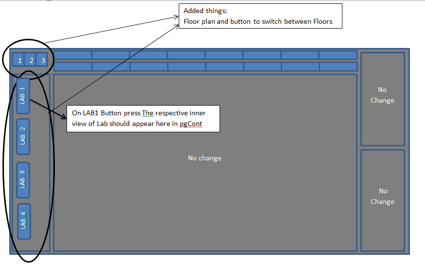

I mean the other button, not the one to select floor plan i.e. button names 1 or 2 or 3).
Each floor plan will have buttons for each lab, which will open the inner view of lab in pgCont area.
Also, For more clear explanation I have attached one image for desired final front end design, kindly have a look.
and is it possible?
Thank you for quick response.
and is it possible?
Sure, just take from the "Root Page(so)" "evProc" attribute's line for mnemo pages open by the button events and place it to this "floor plan" page attribute "evProc" and change here this button ID and related for open page address.
