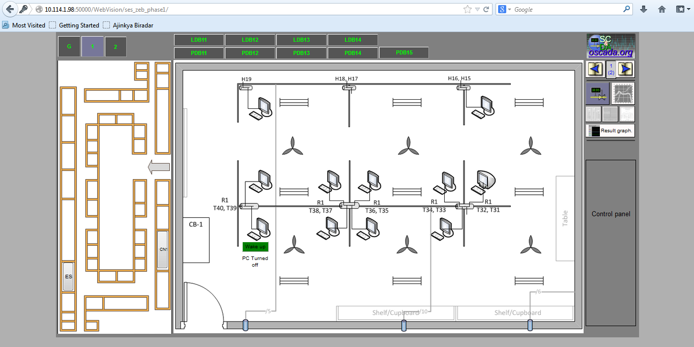

I have a GUI created in figure shown below. When I press switch on button the magic packet should be sent to perticular IP(host).

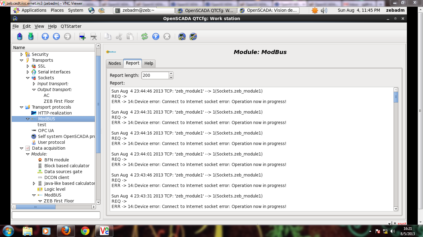

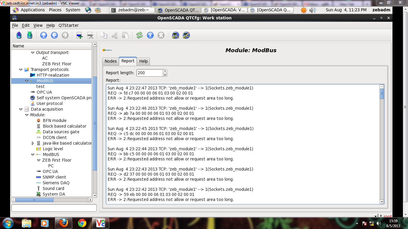

I am getting this kind of response in Modbus-Response tab, when I start the created project in openscada,
--> device error: connect to internet socket error
but and as soon as I start the openscada_AGLKS project I get the error (actually it connects to the socket this time)
--> 2: requested address not allow or request area too long.
again if i close the openscada_AGLKS project, it again says the same thing "device error: connect to internet socket error".
I am sure that I am missing some setting for using MODBUS for my project, but I am not able to locate it.
Kindly Guide on this matter.

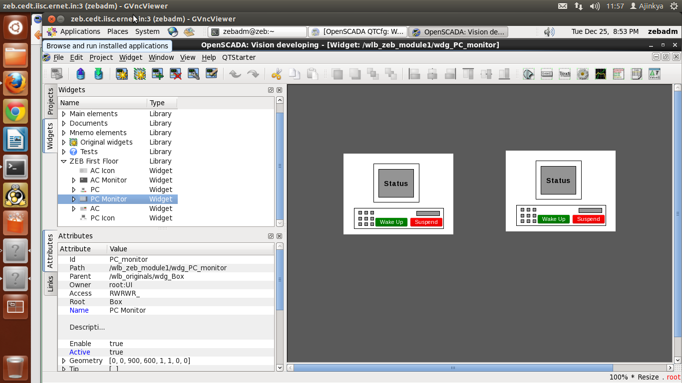

I want to ask, where you would advise to write this script
1. in widgets -> created liberary name-> widget -> properties
2. or in projects -> project name -> root page(SO) -> memos-> added liberary element -> properties
You do not send any request's data.
Here you have incorrect data area request, concrete your device tell this has not register "2"
See to where you send the request and what you send. For examples see to work demo-configuration.
Into Projects tree you deal with the interface's pages but into libraries tree with widgets also then you must write the script into corresponding place. But better way all scripts write only into libraries.

As i mentioned in previous thread, I have my customized front-end ready(with your help :-) ), it can be seen in attachment.
In the attached image there is one button named "wake up". So on that button press event I want to call the system function
ether wake -->> sysCall("etherwake -i eth0 <MAC address>"); <<--
As of now it only seen working in front end , like it changes its color, text on the button to "Turn off" and the status message too, but nothing is written to execute the actual command like "etherwake -----" or "net rpc shutdown --------"
