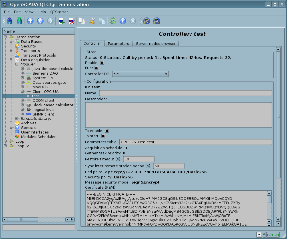

We used the demostation example and OPC-UA without encryption works. With encryption it doesn't.
We are using the official packages from oscada website for Ubuntu 16.04 ( OpenSCADA v0.8.18 )
APT: "deb ftp://ftp.oscada.org/OpenSCADA/0.8.0/Ubuntu/16.04 ./"
What we did:
In the server:
* We removed the "security policy: none"
* We left on Basic128Rsa15, Sign&Encrypt
* We also left on Basic256, Sign&Encrypt
In the client:
We added the security policy "Basic256" (We also tried Basic128rsa15)
We chose Sign&Encrypt
The error message we get is the following one:
Aug 22 04:29:35 xenial openscada: -5[alOPC_UA:test] DAQ.OPC_UA.test: connect to data source: 0x80550000=.
For me that works!
