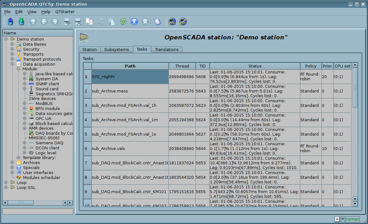

OpenSCADA was able use multiple cores always if manual the CPU/Cores allow into tab "Task": http://wiki.oscada.org/HomePageEn/Doc/ProgrammManual/part4/files?get=sys_tasks.png
But now all the CPU/Cores enabled by default.
