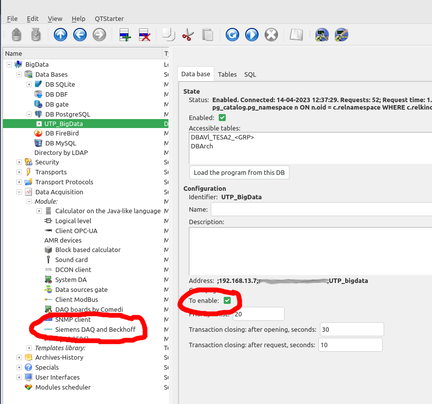

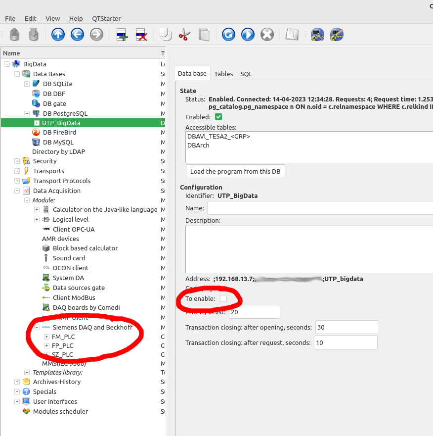

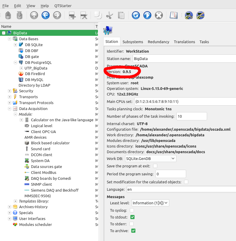

If I have two different database (SQLite and PostgreSQL), openSCADA can't load Data Acquisition's config properly if all databases "To enable".
[This article was edited 1 times, at last 14.04.2023 at 10:49.]

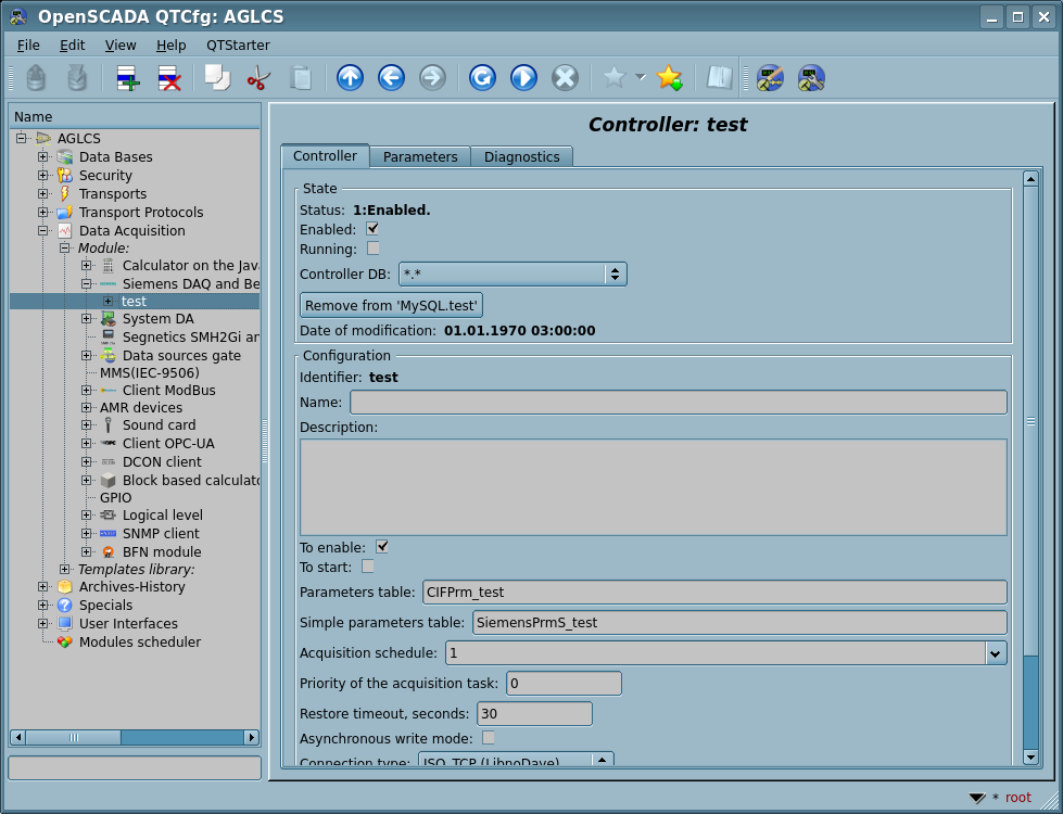

I can, and that works in loading from MySQL and SQLite.
Not a bug!

Templates library loads - OK. I can't load Siemens DAQ and Beckhoff

Please see demo video
bug demo

Previous (0.9.4, 0.9.3...) versions work perfectly. This problem is only with new versions 0.9.5, 0.9.6. I tried the AGLKS configuration and got the same problems.
