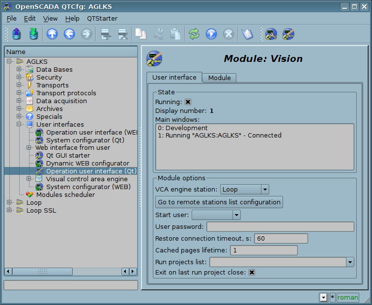

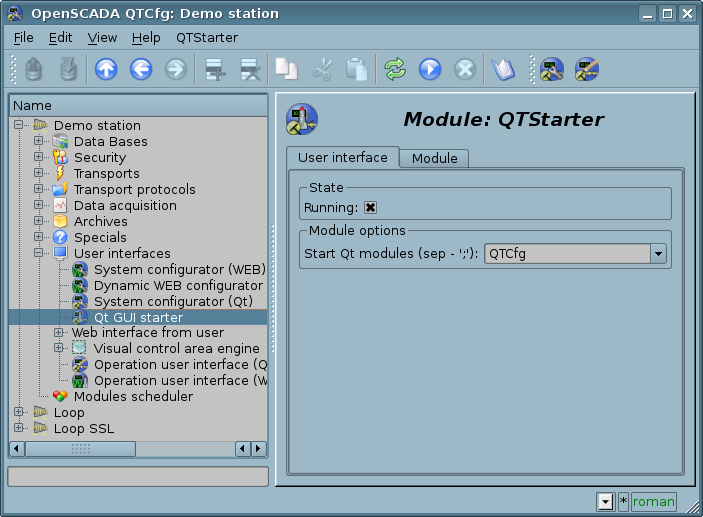

is there an option to start directly into the graphical editor without going through the configurator ?
Regards
Written on: 05. 06. 2014 [09:07]
http://wiki.oscada.org/HomePageEn/Doc/QTStarter/files?get=start_cfg.png
http://wiki.oscada.org/HomePageEn/Doc/Vision/files?get=vis_cfg_en.png
