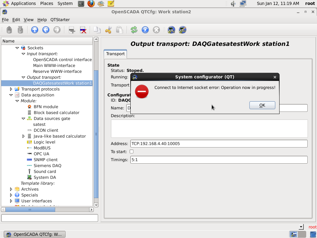

I would like to use DAQGate module.
I run two OpenSCADA in two separated virtual machines. I use these settings for them:
1- Work station1 with IP:192.168.4.40
remote stations list: Work station1
remote controllers: System.test
address: TCP:192.168.4.40:10005
2- Work station2 with IP:192.168.4.41
an output transport is made when DAQGate was configured. but when I want to change the status of transport of "Work station2" to running, it show me an error:
"connect to internet socket error: operation now in progress!" :(
and therefore it remains stopped and I have an error in DAQGate controller of "Work station2".
What's your idea about this problem?
could I use DAQGate for two separated OpenSCADA or it can just operate locally?
Thanks for your attention and help
Remote host 192.168.4.40 unavailable into your network or port 10005 here closed or OpenSCADA here stopped or input transport on 10005 port no present into remote OpenSCADA.

Hi Roman
Thanks for your reply.
I check these thing you mentioned. this is the result:
-I can ping "work station1" to "work station2" and vice versa.
-before trying to test DAQGate, firewall and security software are closed and disabled in order not to block the traffic.
-DAQGates of both stations are running. ("work station1" can read their own data and transport module shows the amount of transmitted data)
-in both stations, their default input transport is running without any error. its address is TCP::10005:1 .
unfortunately I don't know what to do to solve the problem. :(
Could I send you screenshots of the settings in OpenSCADA? (I think it will be more clear)
Any help you can give will be greatly appreciated.

Hi Roman
Thanks very much :) :)
I do everything you said. but I still had the same problem. Finally I find out that Centos is blocked 10005 port, so after adding this port to its firewall the problem is solved and every thing is OK now.
I think, it is as easy as possible to configure this module. Thank you for this friendly module. :)
By the way, I suggest you to add this issue to DAQGate document in order to other users also know about OS port blocking.
