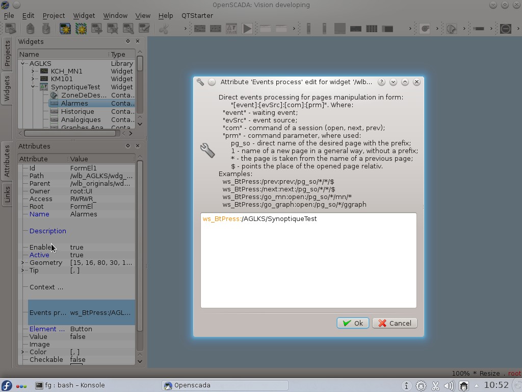

Written on: 29. 04. 2014 [11:56]
fgdevel
fg fg
registered since: 28.04.2014
Posts: 13
See attachment file. I've a "Alarmes" button on my first window "SynoptiqueTest". And I would like to open an other window (for example here, "KCH_MN1").
This is the good path ?
Where I put the code to open another window ?

Written on: 30. 04. 2014 [15:11]
"fgdevel" wrote:
Anyone ?
Read documents and learn examples into DemoDB.
All the questions there described!
