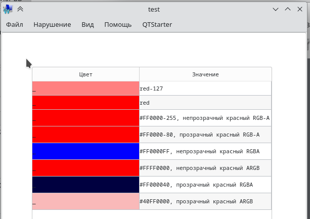

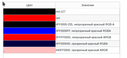

I am attaching an example of a table where this appears and a screenshot.
HTML
<tbl colsWdthFit='1' sel = 'row'>"
<h><s width = '45%'>Цвет</s><s width = '45%'>Значение</s></h>
<r><s color='red-127'>_</s><s>red-127</s></r>
<r><s color='red'>_</s><s>red</s></r>
<r><s color='#FF0000-255'>_</s><s>#FF0000-255, непрозрачный красный RGB-A</s></r>
<r><s color='#FF0000FF'>_</s><s>#FF0000FF, непрозрачный красный RGBA</s></r>
<r><s color='#FFFF0000'>_</s><s>#FFFF0000, непрозрачный красный ARGB</s></r>
<r><s color='#FF000040'>_</s><s>#FF000040, прозрачный красный RGBA</s></r>
<r><s color='#40FF0000'>_</s><s>#40FF0000, прозрачный красный ARGB</s></r>
</tbl>

"walhi" wrote:
And that is not a bug!!!
OK, and where there about bugs?
That is only the WebBrowser behavior at transmission the color in hex, which OpenSCADA treats in noway!

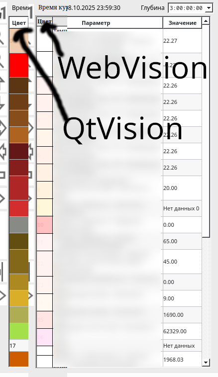

However, as it later turned out, the interfaces in WebVision and QtVision look different, something I only discovered now. I am attaching another screenshot showing the difference in display. The first example showed the working user interface on Qt.
And that is obvious for different visualizers, which smoothing is not a bug fixing also but it is a feature appending.
Your example just show the difference in the extending hex color on Qt and Web, that is the format is not standard in whole and even in Web appeared newly.

And for that I have adapted UI.WebVision for parsing alfa value from OpenSCADA format and placing it to "rgba(red, green, blue, alpha)" in case of hex colors, due to named colors are needed of conversion to hex.
