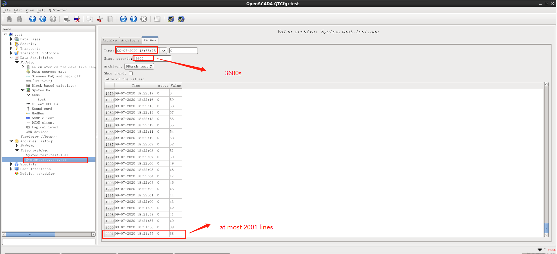

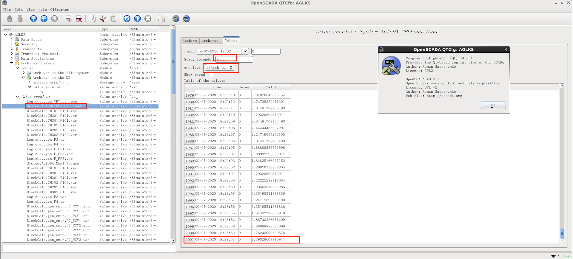

It is only displayed at most 2001 lines by the "Value archive" module of the "Archvies-History" subsystem itthe vesion of OpenSCADA0.9.1-3LTS.There are more than 2001 rows in the database.
The os of my computor is CentOS6_x64.
How to solve the problem or avoid the problem?

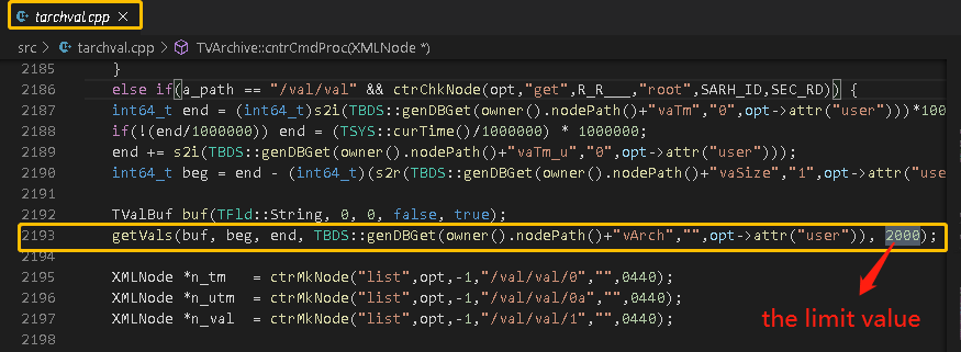

From the source code, I found the limit value.
I think it's better to increase the limit value, e.g 3600*24.
It's just a suggestion.
