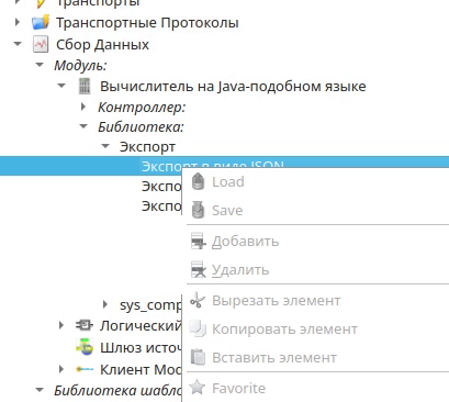

In the DAQ/JavaLikeCalc/Library section, it is impossible to copy or delete library functions through the configurator interface. However, this can be easily done through an XML request from JavaLikeCalc. When connecting the current version to an older one, these manipulations are available on the remote station.

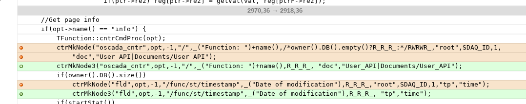

That is about the permissions to the Function node, which were lost during moving the DAQ subsystem under ACL!
And I have fixed that right now.
